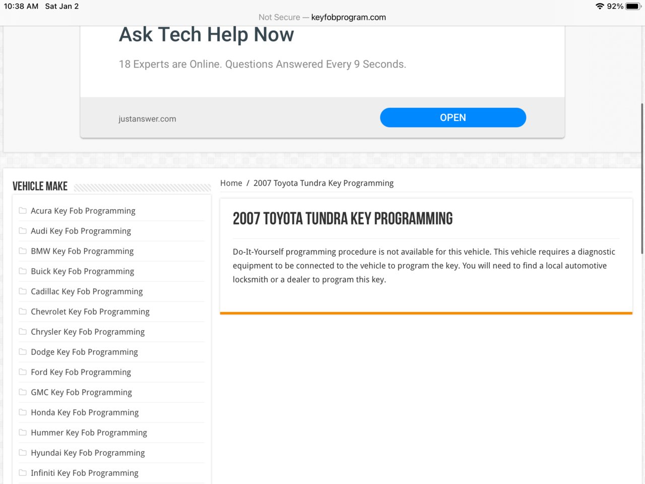

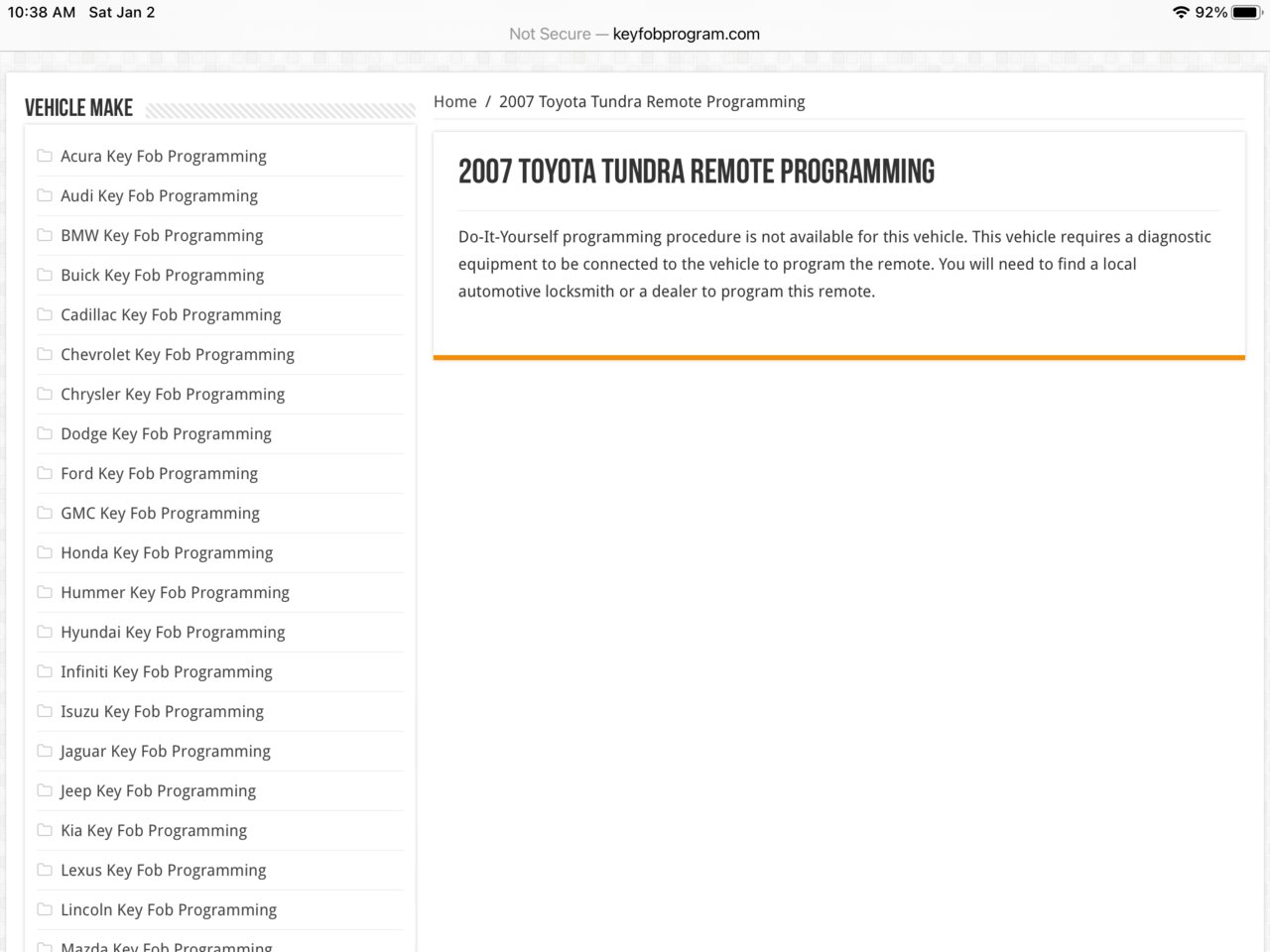

    I just got two keys and two FOBs for my 2007 Tundra RCLB SR5. Both
    RemotesremotesCom & keyfobprogram.com say I need to have a dealer or locksmith
    program them.

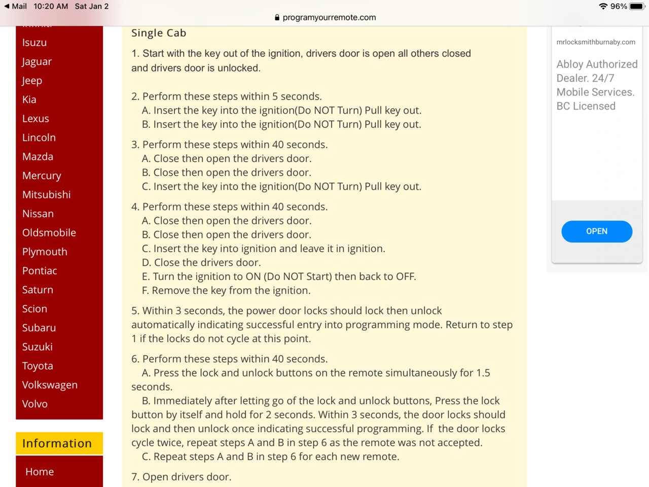

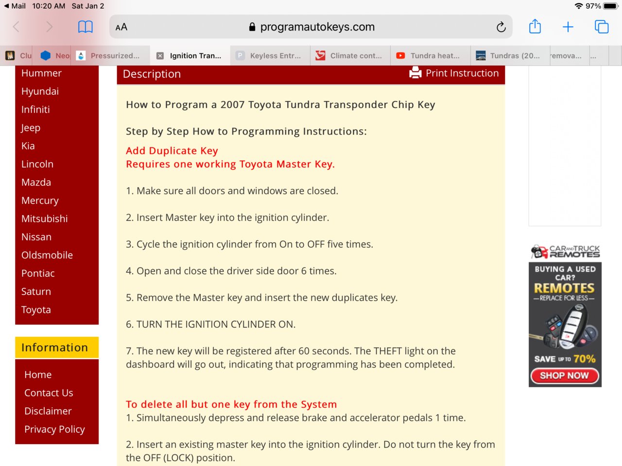

    A buddy found a program programautokeys.com which had a procedure
    that I tried, but it didn’t work. It had a lot of door closing & opening and key turning. It
    would allow the new cut key to turn the starter over, but no ignition.
