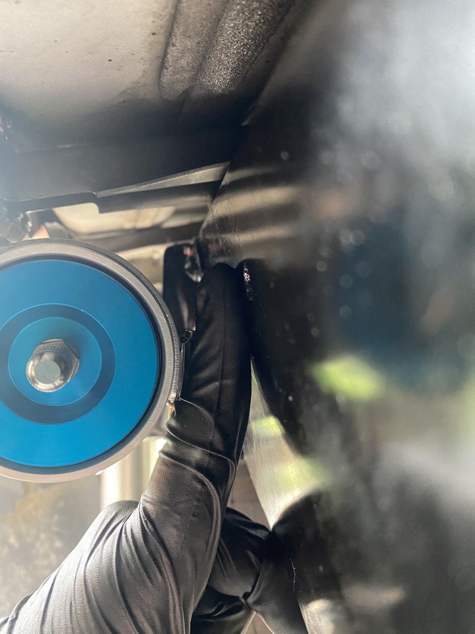

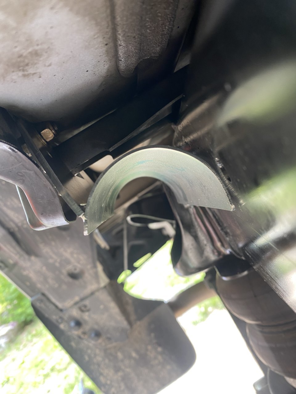

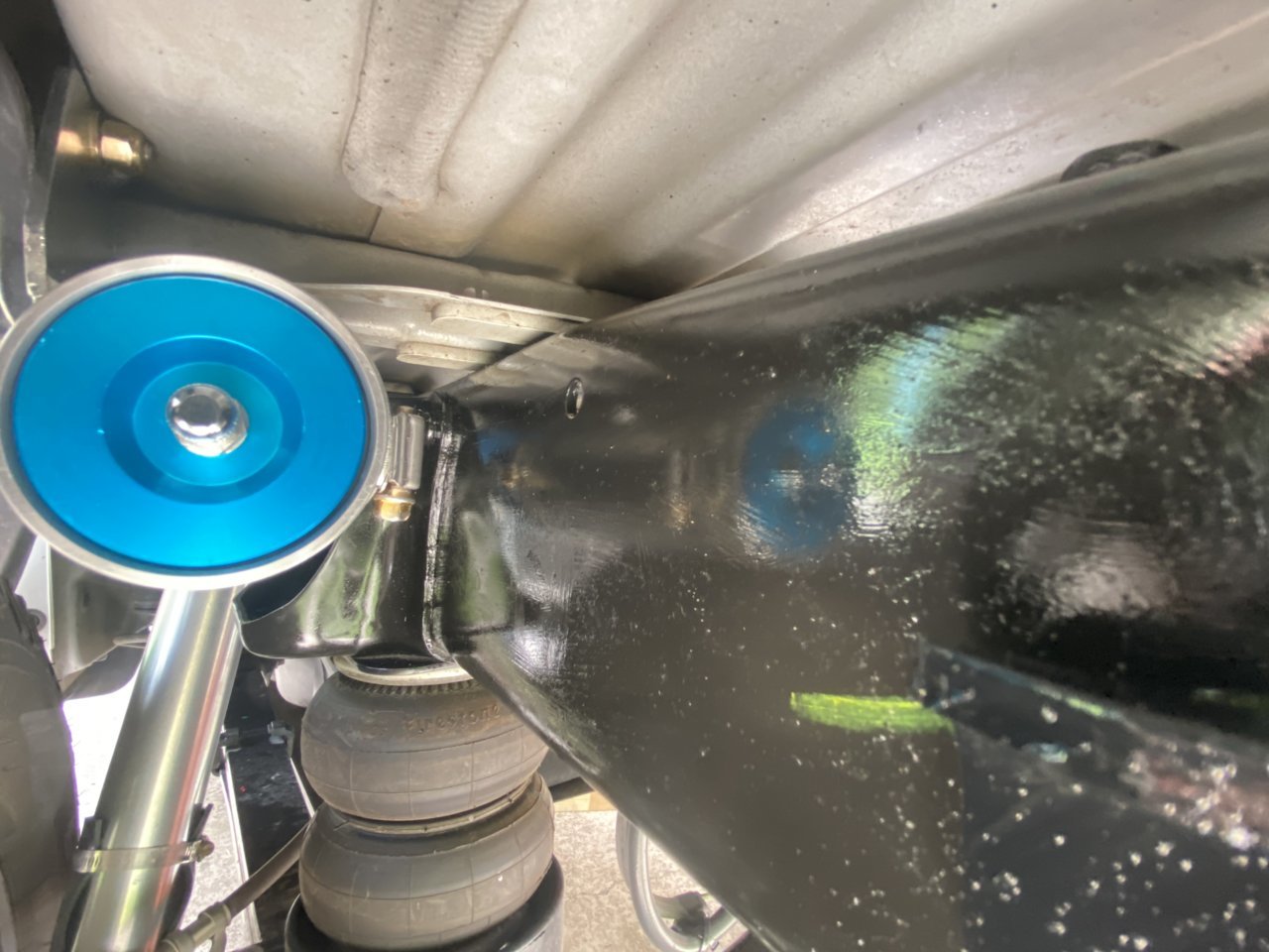

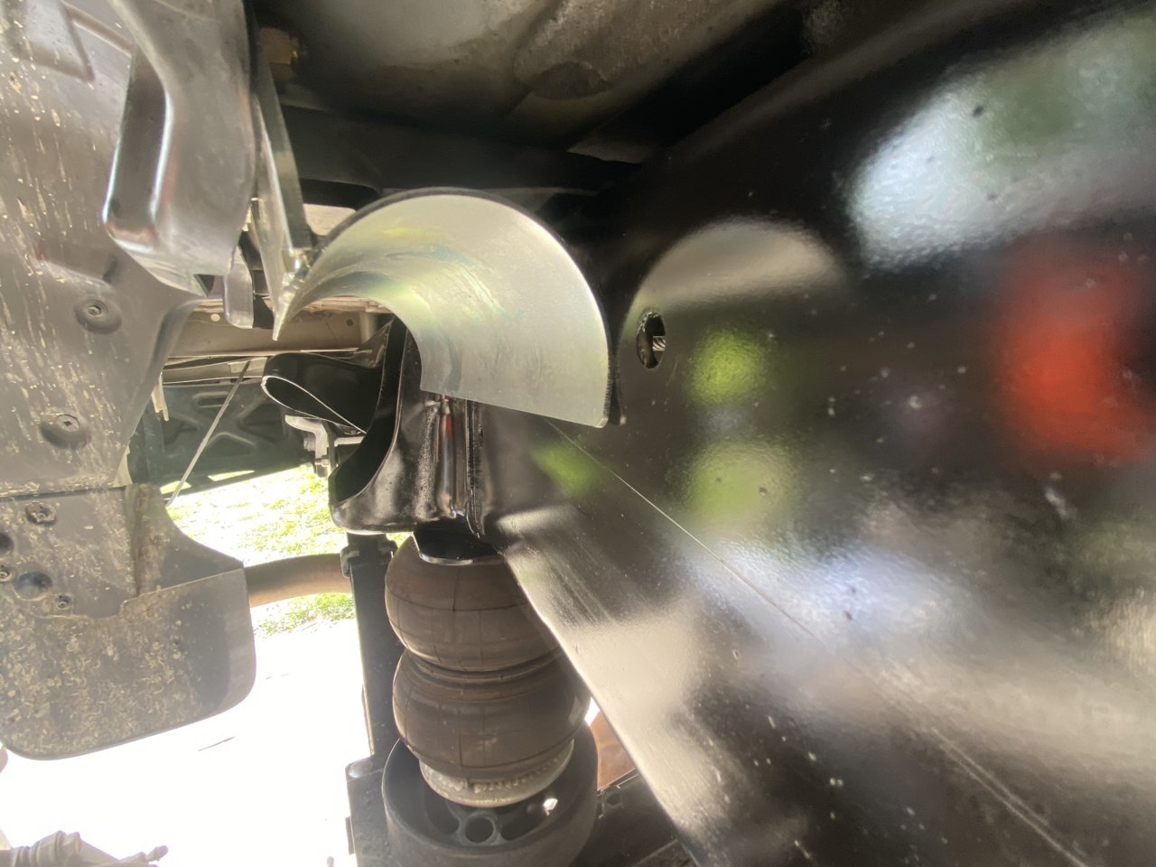

    I’m in the middle of installing King 2.5 OEM rears and need a little help. The driver’s side is installed and I’m now working on the passenger side. I just put on the P-side hanger for the reservoir but it doesn’t look right. The hanger is touching the frame.
    The driver’s side has plenty of clearance but the passenger side hanger is up against the frame. I’ve loosen the bolts twice to try and adjust the hanger but it is still touching the frame. Is this correct? Did I do something wrong?
    Passenger side:
    Driver’s side:
    edit: this might be a better pic:

    I'd put it in a vice and bend the resi holder down more.

    Looks like the passenger side reservoir mount may have been welded in the wrong spot and the tab makes the mount touch the frame.
    You could take it off Lisa and try an massage the mount a bit. Do you have an Oxygen/Acetylene torch with a rosebud? Heat it up and bend the tab back in a bench vise.

    Wish I knew how to wield, that would be awesome. I was able to get the hanger installed in an acceptable manner, just had to ignore the instructions. The instructions show the reservoir hanger on the inside of the bed tab (don’t know what it’s called??). I moved it to the outside of the tab and added a couple of washers. There’s now a finger’s width of space between the frame and the hanger.
    Thanks for the quick response. At least it wasn’t something I was doing wrong which was my main concern.
