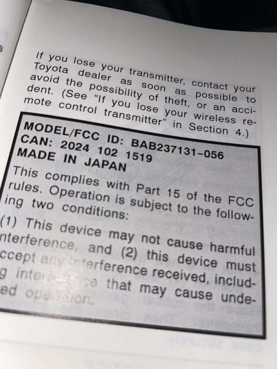

    I recently bought a 2004 Tundra and I was wondering how I could look up which key fob I need I bought one from Amazon but it didn’t work , I did the programming sequence and the truck went into programming mode
    I bought the remote based on what I found in the manual

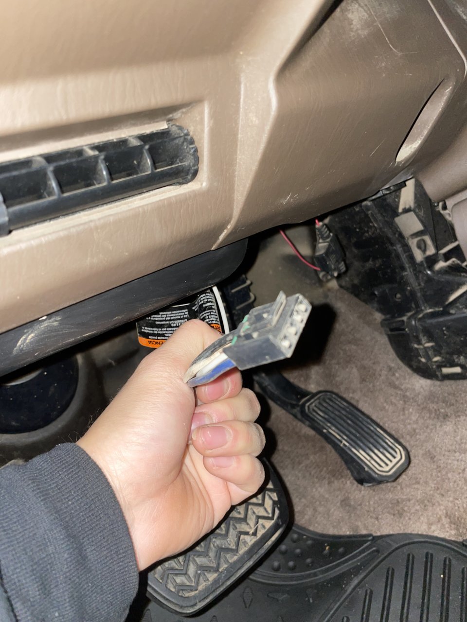

    I also found this plug under the dash that’s just hanging

    Yea I would but I don’t want to buy one just for it not to be the correct one I saw something about comparing the fcc #s on the old key fob but truck didn’t have a key fob

    Plug looks like electronic brake controller.
    there is a thread on keyless. 056 I believe means 3200 aka the good s, lots of info.

    That plug is for a Tekonsha electric brake controller if you're towing a trailer with electric brakes.
