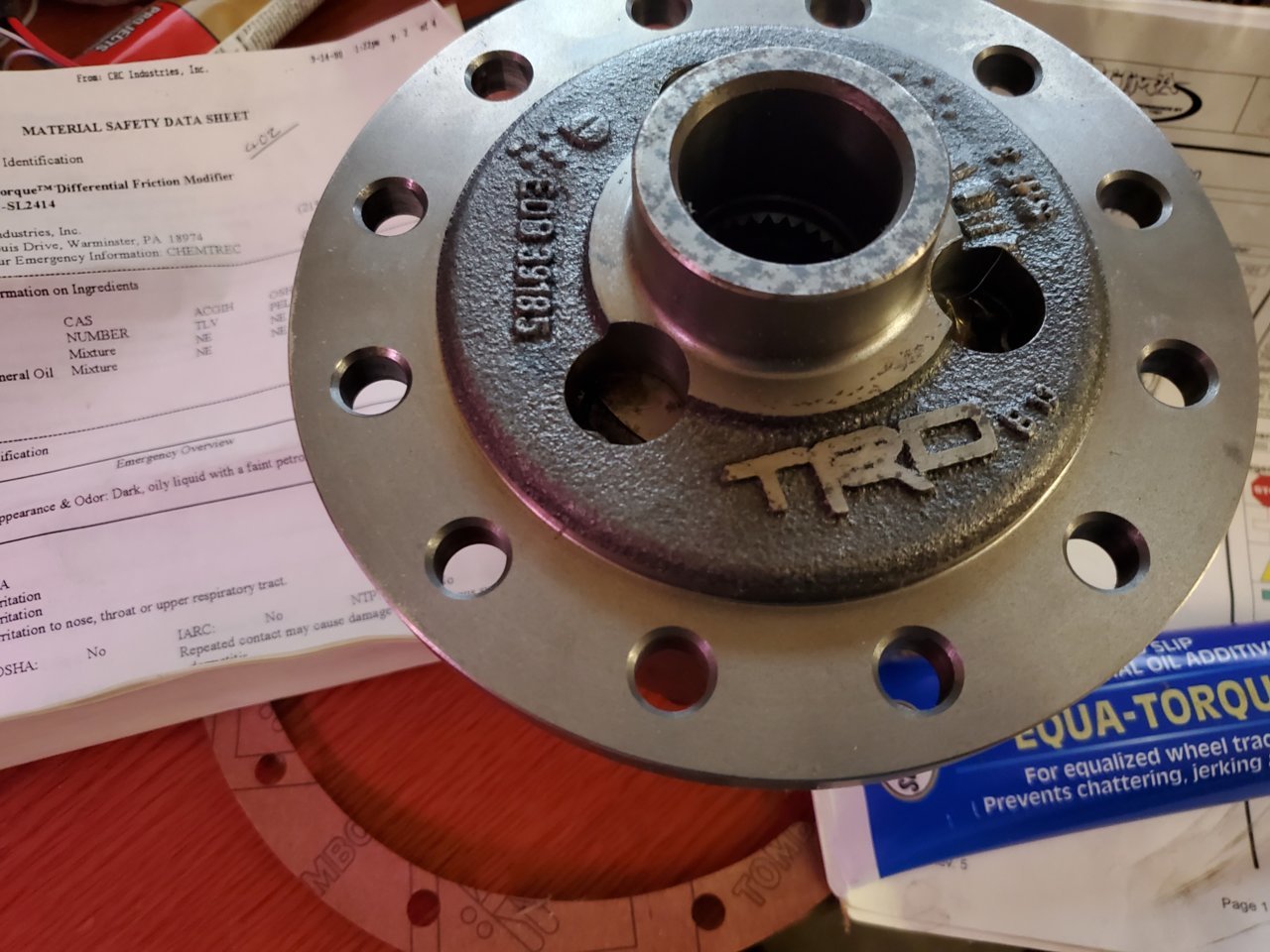

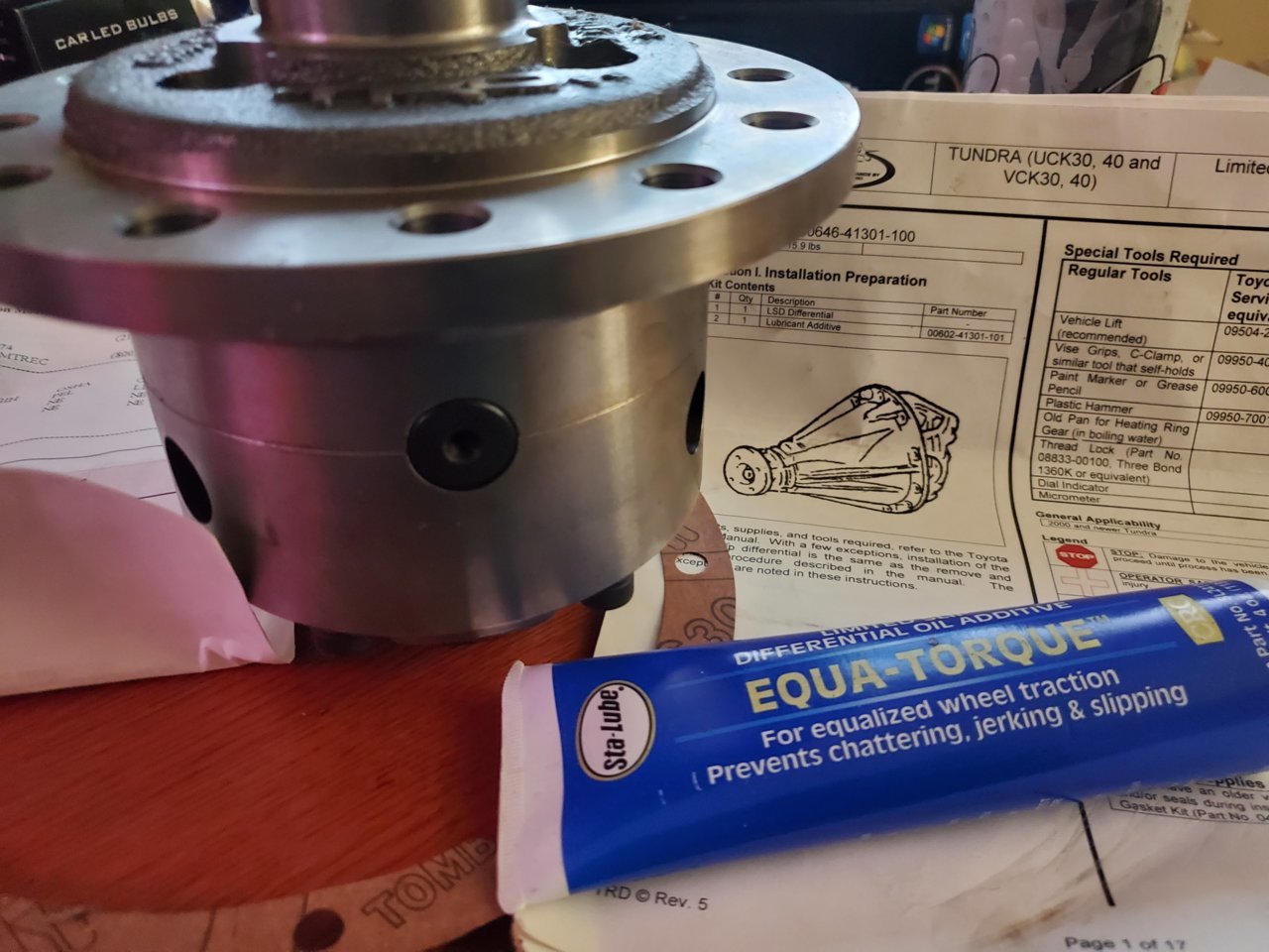

    This is a steal since these things are practically unobtainium (maybe I'm wrong @empty_lord could probably find out) and I think they were $500 or more new. The factory one is pre-tensioned at 200 ft/lbs, while the Kazuma TRD is pre-tensioned at 400 ft/lbs. Even though I have the factory LSD, If I was not planning on going to selectable lockers in the future, I would snap this up.

    I believe the Kazuma uses clutches, hence the need for friction modifiers.

    Speaking of 2 or 3, the Kazuma has 3 forged spider gears rather than the 2 forged spider gears that the other (Eaton) LSD has. I've never found much real info on these units, mostly forum-lore. I do know that mine made a hell of a difference and seeing how rare they've become I'm glad I got it when I did.

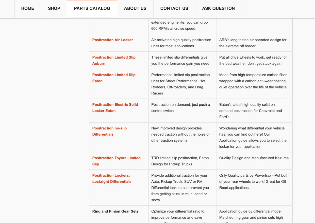

    A side by side description
