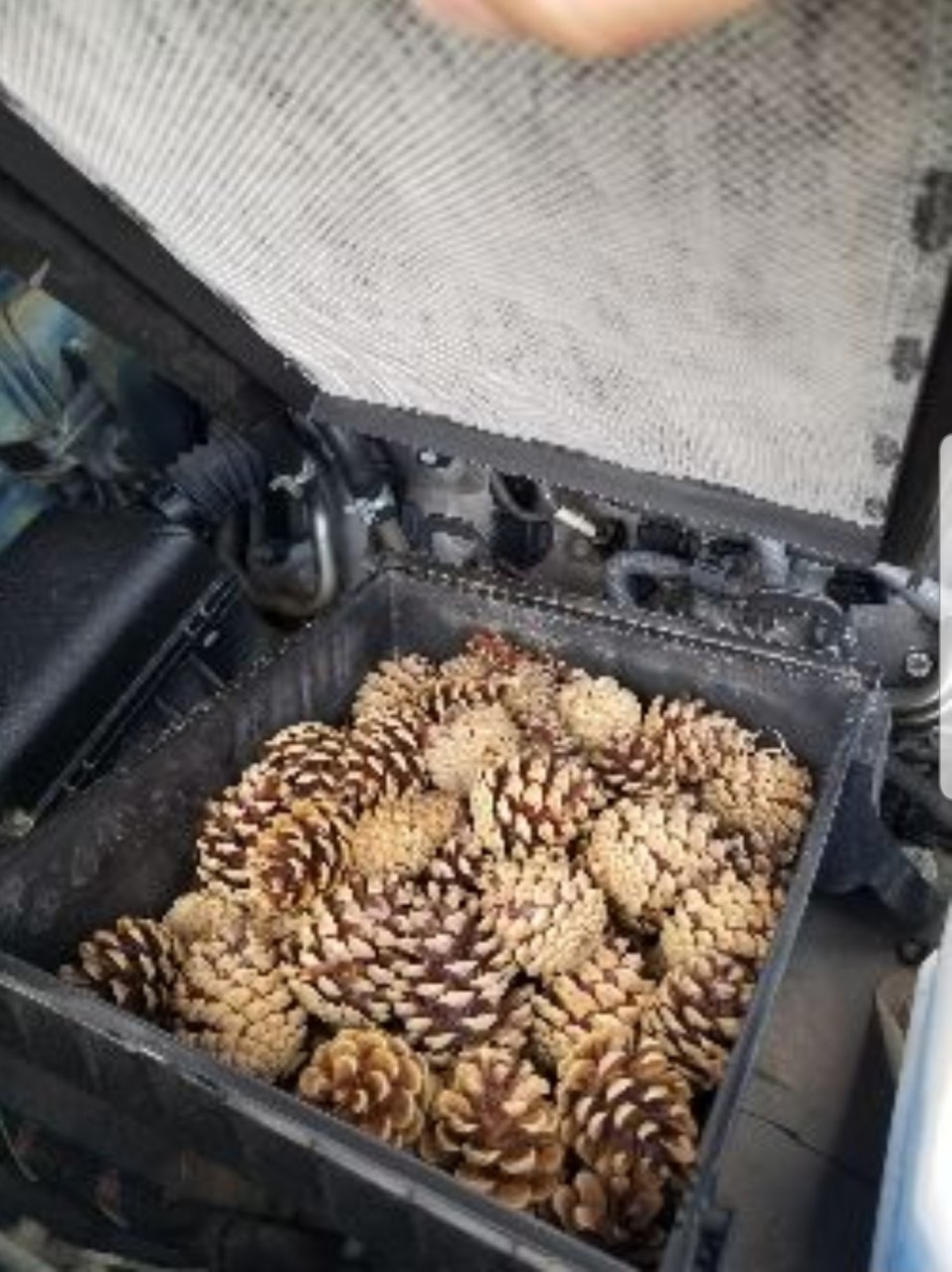

    Soo, I hooked up an UltraGauge and started taking some baseline performance metrics on the Tundra I bought a few days ago. I noticed that my MAF and torque values were lower than I expected.
    I still have to do some basic maintenance items (spark plugs, diff fluid change, etc.) but checked the condition of the engine air filter. Lo and behold, the box was filled to the brim with:
    Once removed, MAF went up by about 20 g/s in case anyone wonders how effective a "pinecone airfilter mod" is.
    We'll see what other surprises are awaiting...

    These were hiding under the air filter. Must have been the stinkin' squirrels.

    I would be checking for holes elsewhere in the intake. If it wasn't someone being an idiot then they drug them up in there from somewhere. Who knows what has fallen into your engine.

    Critters can get into the intake below the filter with ease. They just come through from near the right side wheel well. Mine was stuffed with acorns, stashed there by mice. I've since made a screen of 1/4" hardware cloth to keep them out. And also better sealed the garage doors to keep them out of the garage altogether.

    Took a deeper look and everything in the engine bay is in the clear so far. No visible damage to the engine harness and wiring. No holes in the intake.
    Pine cones were on the bottom of the air filter and carbon filter and unable to enter the engine. I found a few more cones in the passenger side front bumper. Previous owner lived in the mountains and didn't drive much so hopefully the rodents didn't follow the truck into the city where I live.
    I can see how they would get into the box through the passenger side behind the right front fender. It's just a big 3" opening into the airbox. I like the idea of putting a custom screen there just in case.
    Took out the heater fan and inspected and it was completely clean. No cabin air filter on the 1st gen. The heater fan blower makes a small clunking sound but that is a separate issue I'm tracking down. Looks like there is a little play in the motor shaft and the fan cage is slightly out of round.
    I'm getting a max MAF of 170 g/s at 5000 rpm which puts me at 212 HP or about 75% engine load. I need to do a few more test runs up a hill under load to see if I can get better readings. I'm at 5000 feet altitude which could be affecting my air flow to begin with. With the pine cones in place, my MAF was 145 g/s at 5000 rpm. Ideally, I should be pushing 225 g/s to reach the advertised 282 HP.

    Hahaha....join the club....my 2017 was filled..enough to crush the air filter and there was another dozen caught in the wheel well...no issues, no codes, no engine light....(sorry for poor picture)...emptied, cleaned box, new filter=good to go!!!! :rofl::rofl::rofl:
