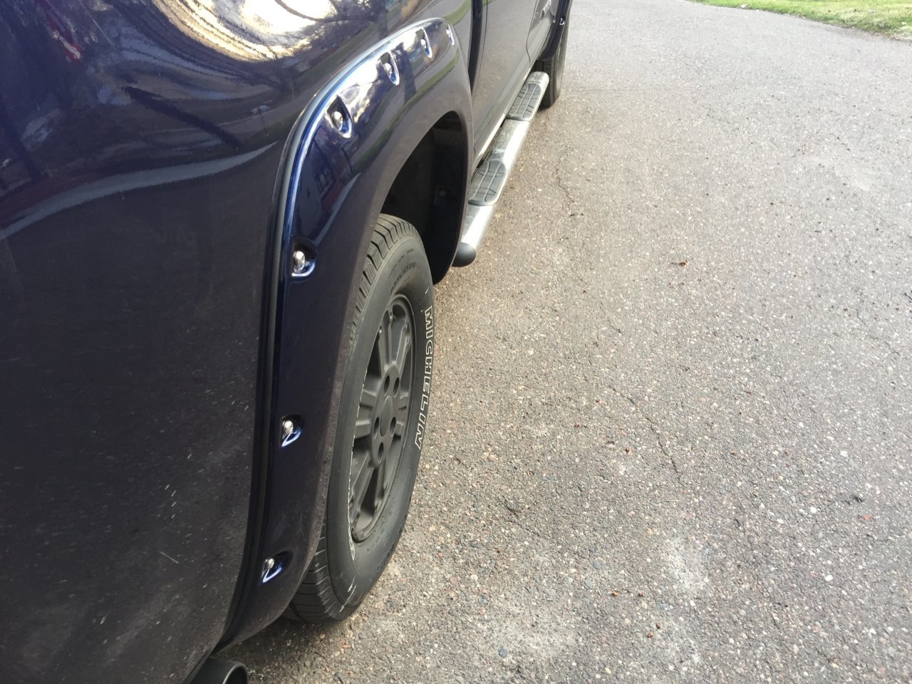

Just got my fender flares installed. Now I need bigger tires

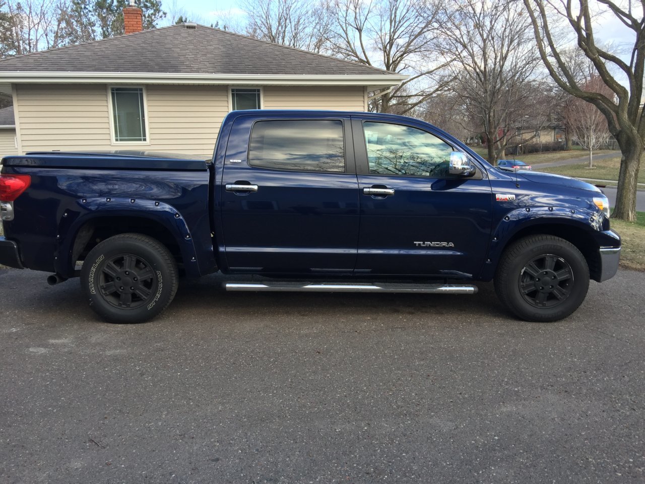

    39329C1C-3ED1-47A5-A3AE-BAC5B356BDD6.jpg 8698F27C-0708-4758-B8F1-4FCF83BA6753.jpgD4EF74AE-437D-49FD-BEDA-BA7883A037CD.jpg bought used bushwhacker flares off CL for one bill. Had them color match painted for two more bills. Now my stock tires look tiny. I will probly go with a 3 to 1 level kit from Toytech and get some Black Rhino 18” wheels. Everyone talks about 25 offset is the magic number for our trucks. With fender flares is there another magic number to push them out to the edge of flares? As always. Thanks for all help. Peace. D

    Good CL score.
    +25 is a good place to start. The closer to 0, the more the wheel is pushed out and the greater the chance of rubbing. A good source of picts is https://www.customwheeloffset.com/wheel-offset-gallery. You can search by offset and tire size and see picts of how far the tire sticks out. This is mine with a +25 wheel and 295's.

    I like your stance. That
    is all the stance I need. Thank you. D

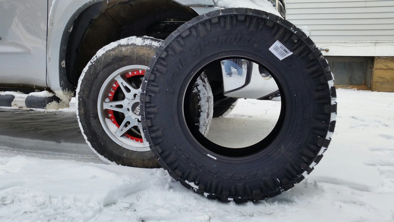

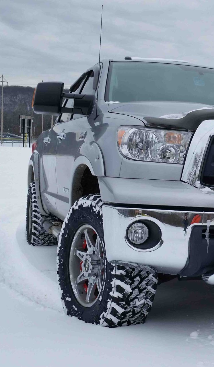

    I have 18 mm offset wheels with 295s. My tires are just about flush with pocket style fender flares. With 18 mm offset wheels, 295/70/18 is just about the max size you could go with without cutting up your truck.

    Mine is 18x9. My tires are very close to the body mount, but they do not rub. I know that when mounted, tires do look smaller, but you could see Trail Grappler 295/70/18 next to stock 275/65/18.

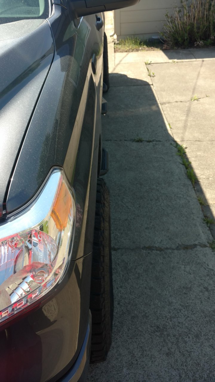

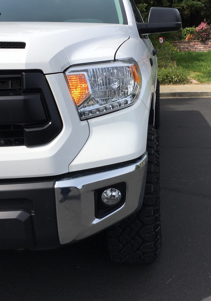

    Thanks. Wheels are 18x9 with a +25 offset and the tires are GY Duratrac 295/65R18. The front is lifted 2" (5100's on the middle setting with 1 coachbuilder shim on each side) and the rear is stock height. I had to remove the front mud flap and push the front liner in about an inch and there is no rubbing even at full lock.

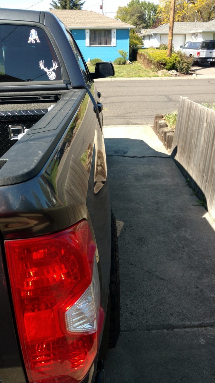

  12. May 5, 2018 at 9:32 PM
    jewsNbrews
    Apr 16, 2018
    #14506
    9,768
    Jewiston Idaho
    2019 TRD PRO
    Bolt on

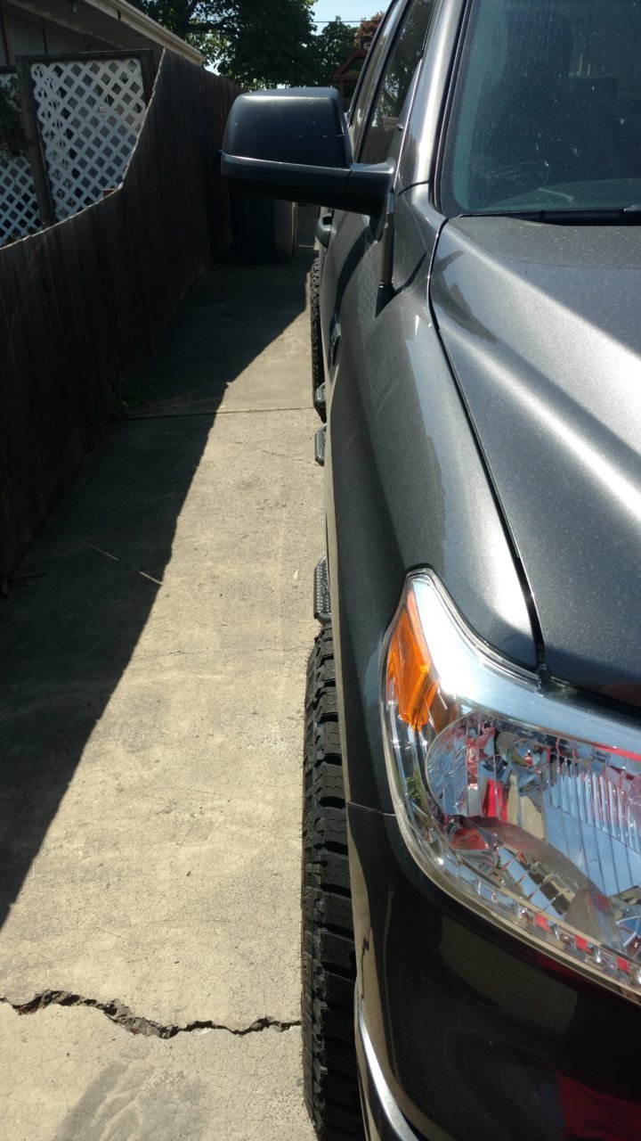

    +25 offset will still keep you pretty close to under the wheel well. With flares I'd go with -20-+12 offset. But mine is a third gen, not sure on second gen. I posted some pics of my new set up that's slightly aggressive with no flair's.

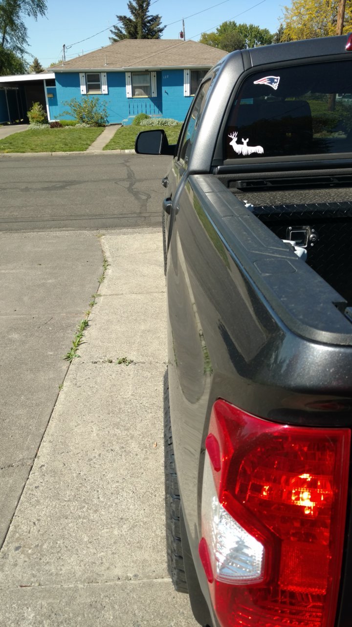

  16. May 5, 2018 at 9:50 PM
    jewsNbrews
    Apr 16, 2018
    #14506
    9,768
    Jewiston Idaho
    2019 TRD PRO
    Bolt on

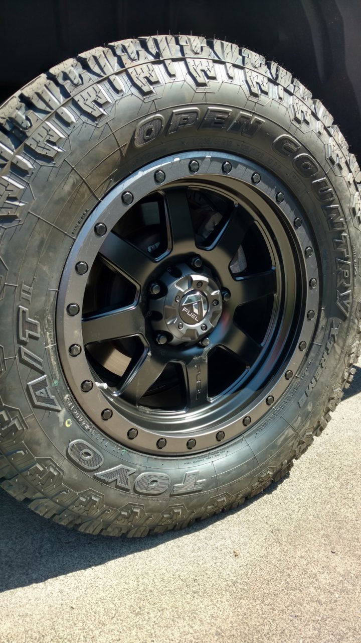

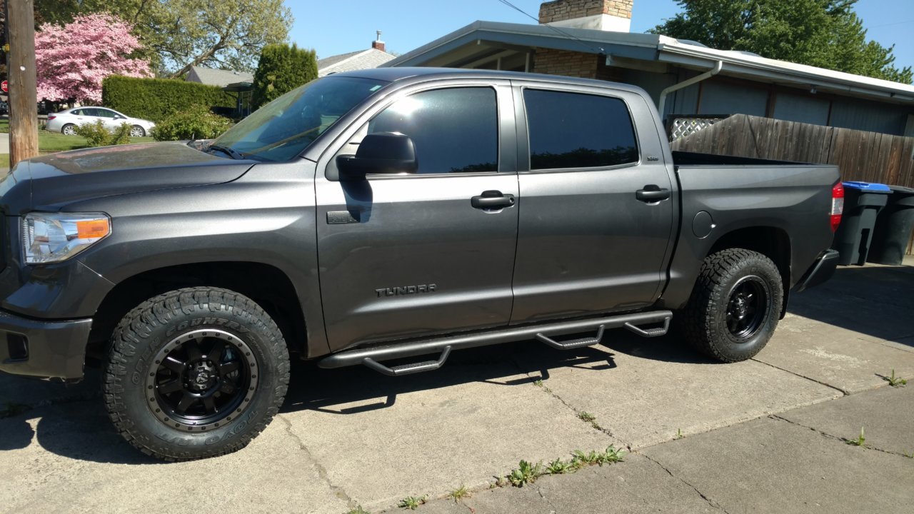

    Here she is. Side view with 4 corners view.

    Bad ass! Thanks for posting. I see what you mean about the snugness. What dizeare those tires? Thanks so much.
    BTW gotta love your handle. :rofl:
  19. May 5, 2018 at 10:03 PM
    jewsNbrews
    Apr 16, 2018
    #14506
    9,768
    Jewiston Idaho
    2019 TRD PRO
    Bolt on
    Tires are 285/65/18 Toyo open country A/T II
    Truck is stock.

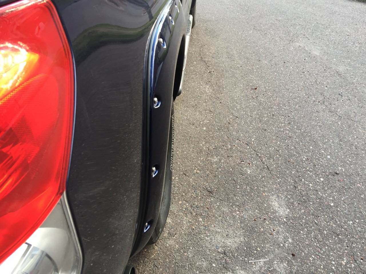

    +20 offset is perfect for those in my opinion without fender flares.
    My 295's +20 before adding my Bushwackers ...
    current set up on 295's with 1.25" spacers = -6 offset and Bushwackers ...
    unfortunately going this route means you will need to do some minor tweaking of the liner and a CMC for peace of mind.
