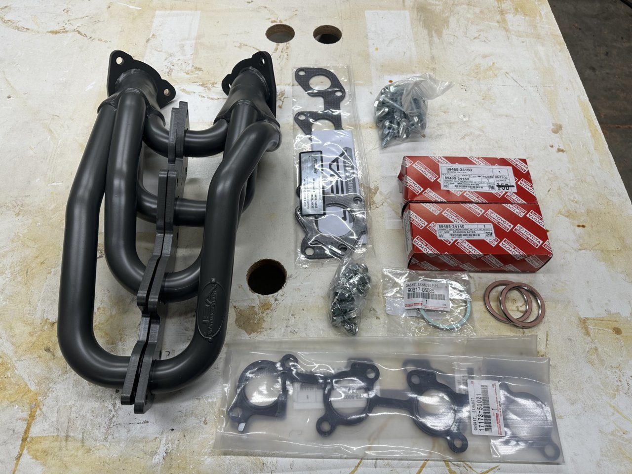

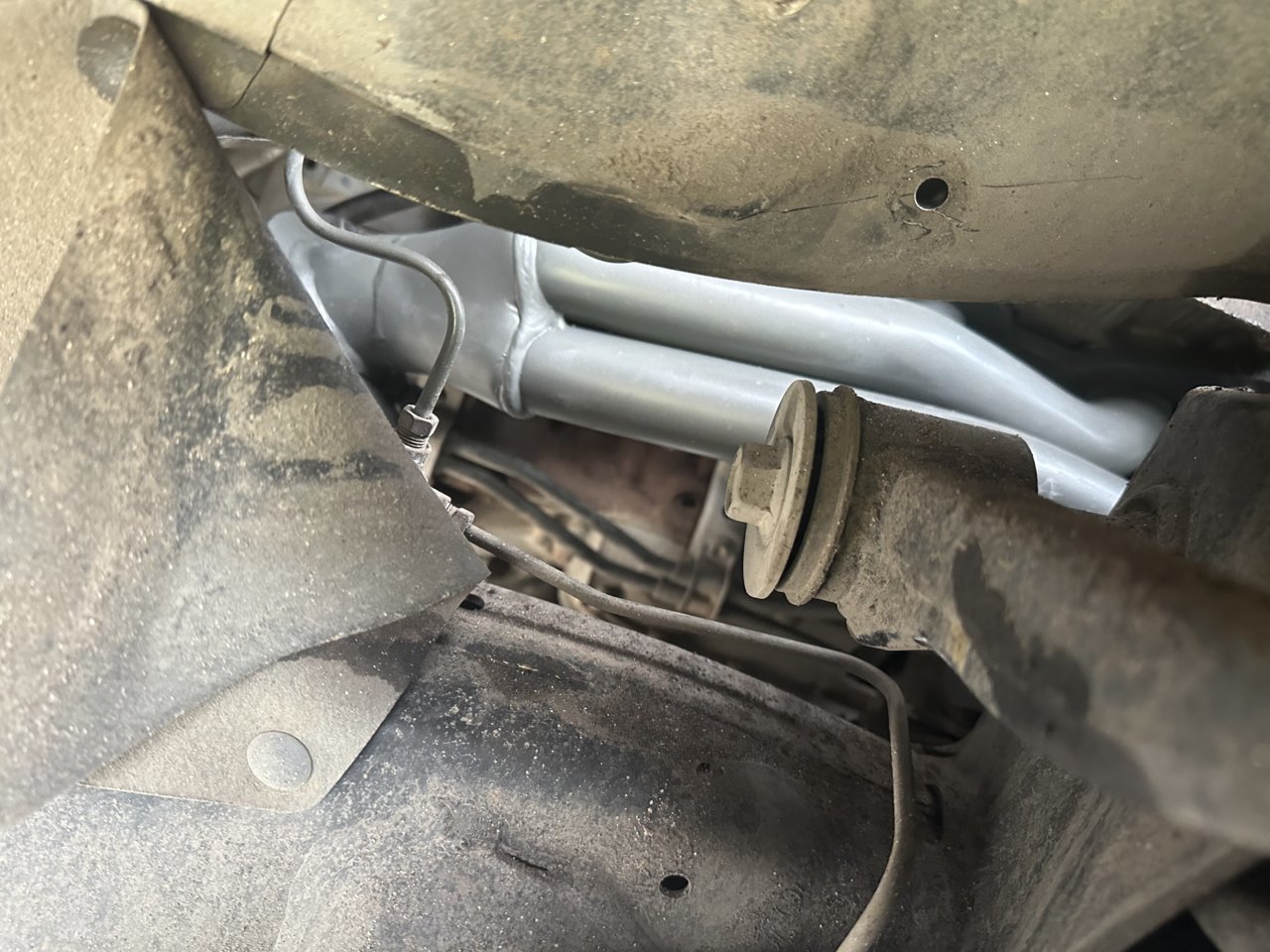

    I just did this to my sons truck. I got 20% off on the the ceramic coated headers through Autozone online. Paid $609 for the titanium ceramic coated version deliver to my door. I replaced all of the nuts and the upstream and down steam O2 sensors with OEM Toyota Parts. Install labor is a killer.

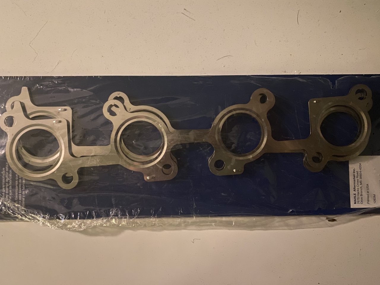

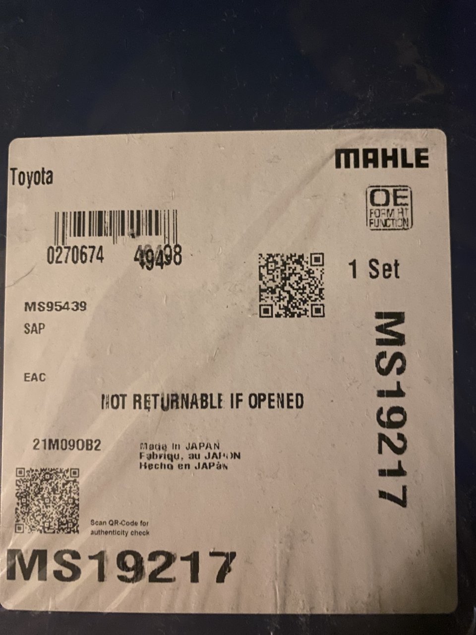

    MAHLE MS19217 Arrived today. Made in JAPAN
