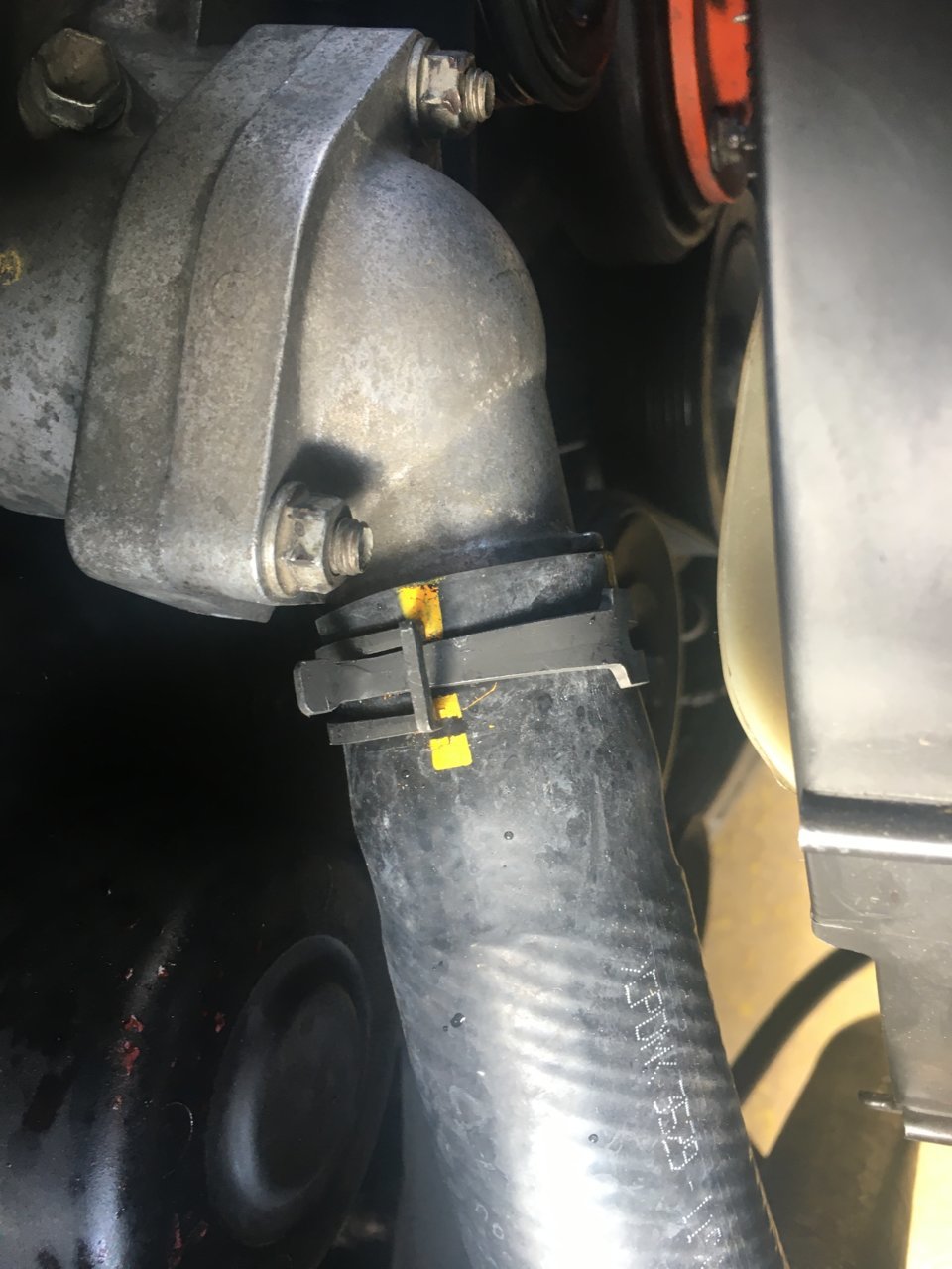

    central valley, CA
    2001 Toyota Tundra SR5 V8
    FINALLY was able to do the job today, just took a while between work and other around the house stuff to get to it. It was a pretty simple process.
    1. Pinch off the two aux transmission coolant lines to the bottom of the radiator with some towels and vice grips.
    2. Open the petcock and drain, then close the drain.
    3. Remove the hoses (the bottom of the radiator screw type clamps to the hose were horribly corroded, gross and I could barely get it off). I replaced both the upper and link to the lower hoses at once... just because they both were old and why not.
    4. Install the new hoses with the new correct spring type clamp.
    5. I followed the guide similar to this video on how to bleed the system.
    https://www.youtube.com/watch?v=oQsxmi-CNng
    I drove it about 2 miles which is about how long it took for the leak to happen before. Fingers crossed that the leak doesn't re-appear. After I took the old hose off it was so compressed/deformed by the old screw type clamp i'm not surprised that it couldn't hold the coolant back. Thanks for the suggestions all.
    The new hose and clamp where the leak was coming out of. All fixed.
