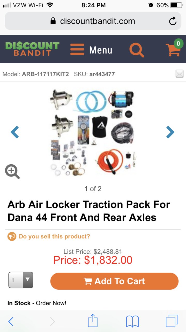

    Cost wise (including re-sale value) I would think it’s better to sell the 2wd and replace with 4wd. Unless you’re going for some specific pre-runner style rig. IMO
    I’d guess around $1200 for a locker and $600 labor.
    I didn’t shop 2WD’s so don’t know the price difference.
    I do know a locked 2wd doesn’t go as far as an unlocked 4wd (90% of the time). I always gave every obstacle a go in 2wd with the rear locked before moving into 4wd. That’s a different wheelbase (4runner) though.

    Only downside would be if you didn’t go selectable. I don’t know what’s out there for a Tundra, but I wouldn’t recommend a spool or full time locker on a DD’d rig.
    ARB is selectable, so no downsides except cost. And drilling a hole in your housing - but not really a big deal.

    Looks like it would be more like $2500 I’d guess. With the ARB I forgot you need the compressor and air line kit. $1800 just in parts, $600 in labor I’d say is on the lean side. More like $800 install.
    I had ordered from Just Differentials and they sent out a loaded third member, just sent them my old one back in. It was cheaper and did the labor myself.
