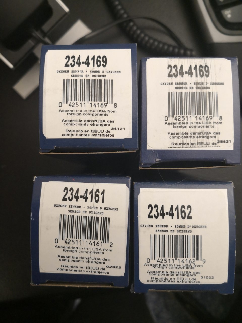

    No difference in performance after changing my O2s and clearing a 200-mile driven P0031 code.
    Here are all 4 Densos. The 169s are the upstream 2. 161 is downstream driver side, 162 is downstream pass side.

    That’s strange you have two part numbers for the rears, they should be the same

    Speaking of an 04 DC only, the rears are different. The harness for driver side is approx 6" longer. Which means it's difficult if not impossible to swap sides for troubleshooting to see if code follows.
    These are OEM from Cool Springs dealer @Roman on an 04 DC....
    Rear Oxygen Sensor, Left 89465-09320
    Rear Oxygen Sensor, Right 89465-09380
    Ft Oxygen Sensor, Left 89465-0C150
    Ft Oxygen Sensor, Right 89465-0C140
