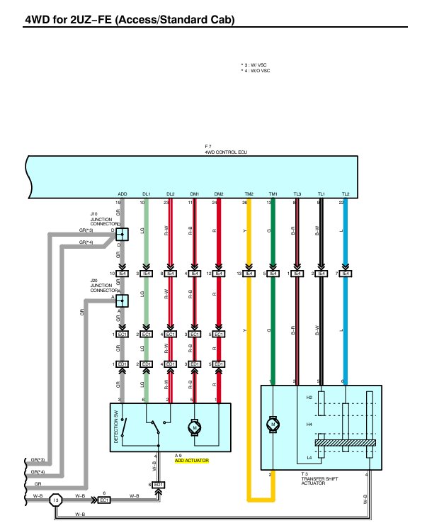

    I've only heard of people doing them when going to manual transfer cases like the Sequoia/4Runner ones. Some people go to the manual transfer cases in these trucks when their transfer case actuator goes out, then use a disconnect switch to engage the ADD.
    If you add the Eaton E-locker, definitely keep it disengaged on the pavement. Only time it would be fine to run locked would be in full 2WD but I'd think that would make your steering much more difficult. I wouldn't run 4WD front locked on pavement regardless of 4WD or AWD. But theoretically if you have the E-locker engaged and ADD disengaged, your truck technically becomes 3WD.
    To trick the transfer case, you might be able to run a switch off the solid blue wire on the transfer case. When the switch is on, the 4WD system will work normally, and when the switch is off, it disconnects the wire, making the 4wd system think it is in 2wd. There may be an order you have to turn the switches on when you're switching from 2WD to 4-HI then 4-LO, I'd have to read the EWD more to figure out that order.
    There is a company that sells an ADD disconnect harness for transfer case swaps, but I'm struggling to find it right now. Can't remember if it tied into this blue wire, or into the wiring on the front diff actuator.

    I'd get the wiring diagram for your year here and look at page 172 through 175 to get started on a disconnect switch. https://www.tundras.com/threads/ultimate-tundra-wiring-diagrams-collection.81448/
