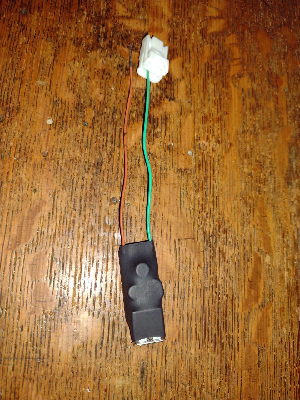

    I used to make the adapters as a hobby until Dongar spun up on them, see pic below. The connector can be pinned to either Hot or Ignition. Another Dashcam thread on that somewhere here. Then I cut off the Dc-Dc convertor and put on the Vantrue N4 hardware kit since my truck sits for a week most day. That is the way to go.
