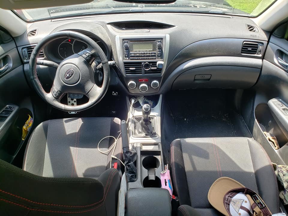

    F****d Up Interior Photos & How I Fixed 'Em
    Subaru WRX
    A lot of these pictures washed out in the sun so you can't tell how bad the seats were, but the owner used this WRX to hunt out of...so you can imagine.
    This one got a full carpet and upholstery seat extraction. Much of the hard plastic surfaces were cleaned with 50:1 or 30:1 APC. Some harder spots got the steamer.
    Before:
    After:
    2008 Jeep Liberty
