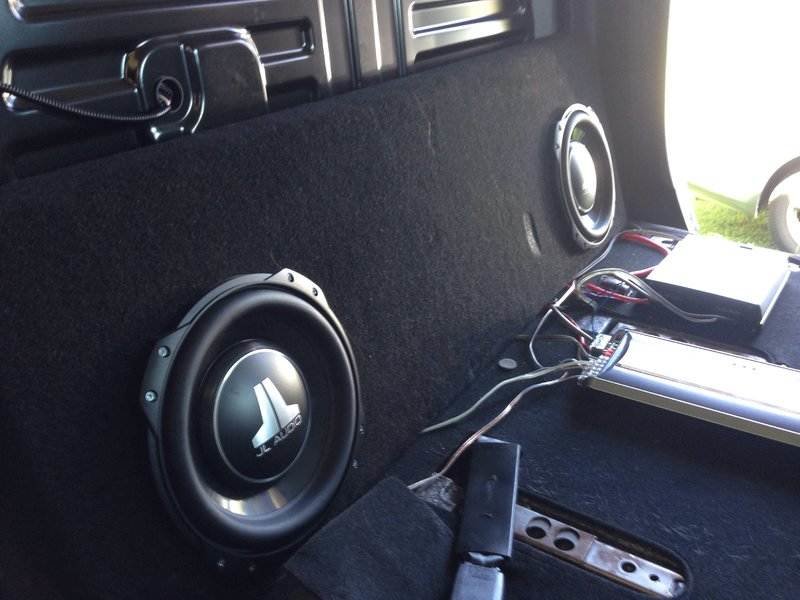

    2014 Tundra Crewmax limited Stock player but installed the following:
    1. Pair component mids and tweeters Infinity Kappa 60.11 in stock locations(doors and dash)
    2. Pair coaxials Infinity Kappa 60.9 rear doors.
    3. Pair 10" subwoofers JL Audio 10TW3 in full length sealed box.(subs hit hard) behind rear seats.
    4. Subs powered by JL Audio 1000/1d monoblock. Under rear seat.
    5. Mids and Highs powered by Infonity Kappa Five 5channel amp. Under rear seat.
    6. Signal processor Recurve Ezq (*********). Strong signal super clean no distortion or interruptions. Under drivers seat.
    Bass knob left of center console side nearest my right knee while driving.
    MotoTundra likes this.
