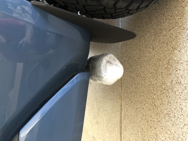

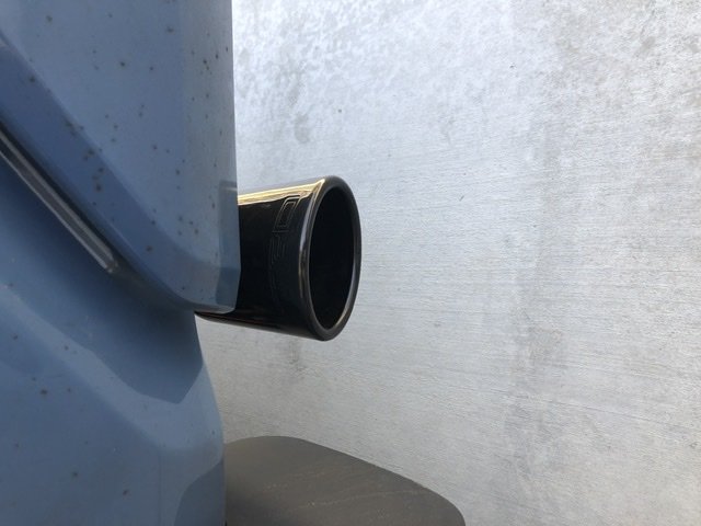

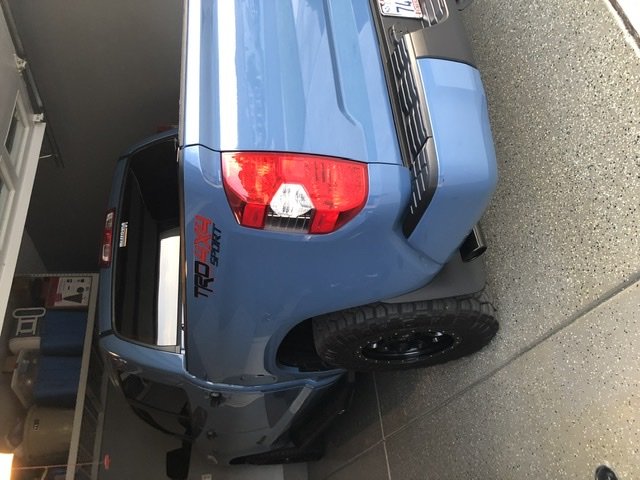

    262C1769-7460-4E9B-8FA9-FAF0A397CC15.jpg Summary, install took two hours with two people. First thing, my new system did not come with installation instructions, is Toyota cutting paper costs now?
    All other parts were accounted for. The passenger side tip sits 1/2” lower than the driver side, like others said, I’ll need to order a new rubber hanger.
    After driving it 100 miles it is still breaking in and both spitting and burning off oils. The kit looks good and the rumble is just right for me. I’m a parent to young children, so I needed something that I can hear and feel when I want it but be subtle at times as well. Looking forward to running this system for 500,000 miles!:)
