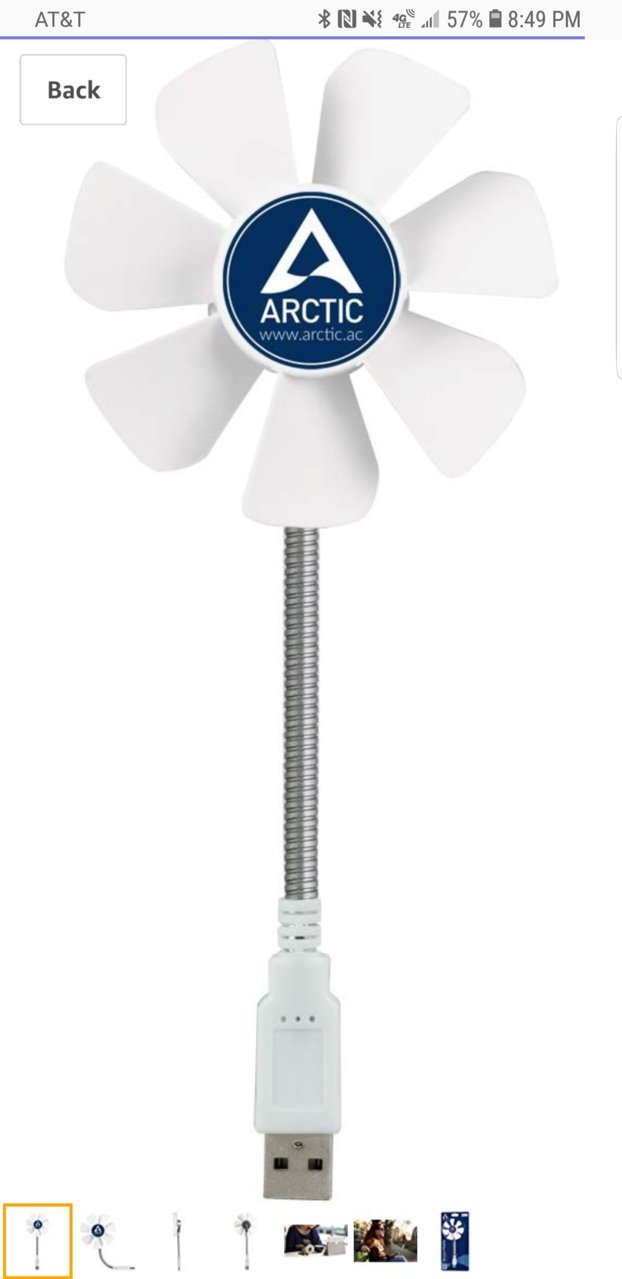

  21. Aug 29, 2018 at 10:59 PM
    Punisher17
    Punisher17 New Member
    Oct 30, 2017
    #10638
    302
    I bought this lol
