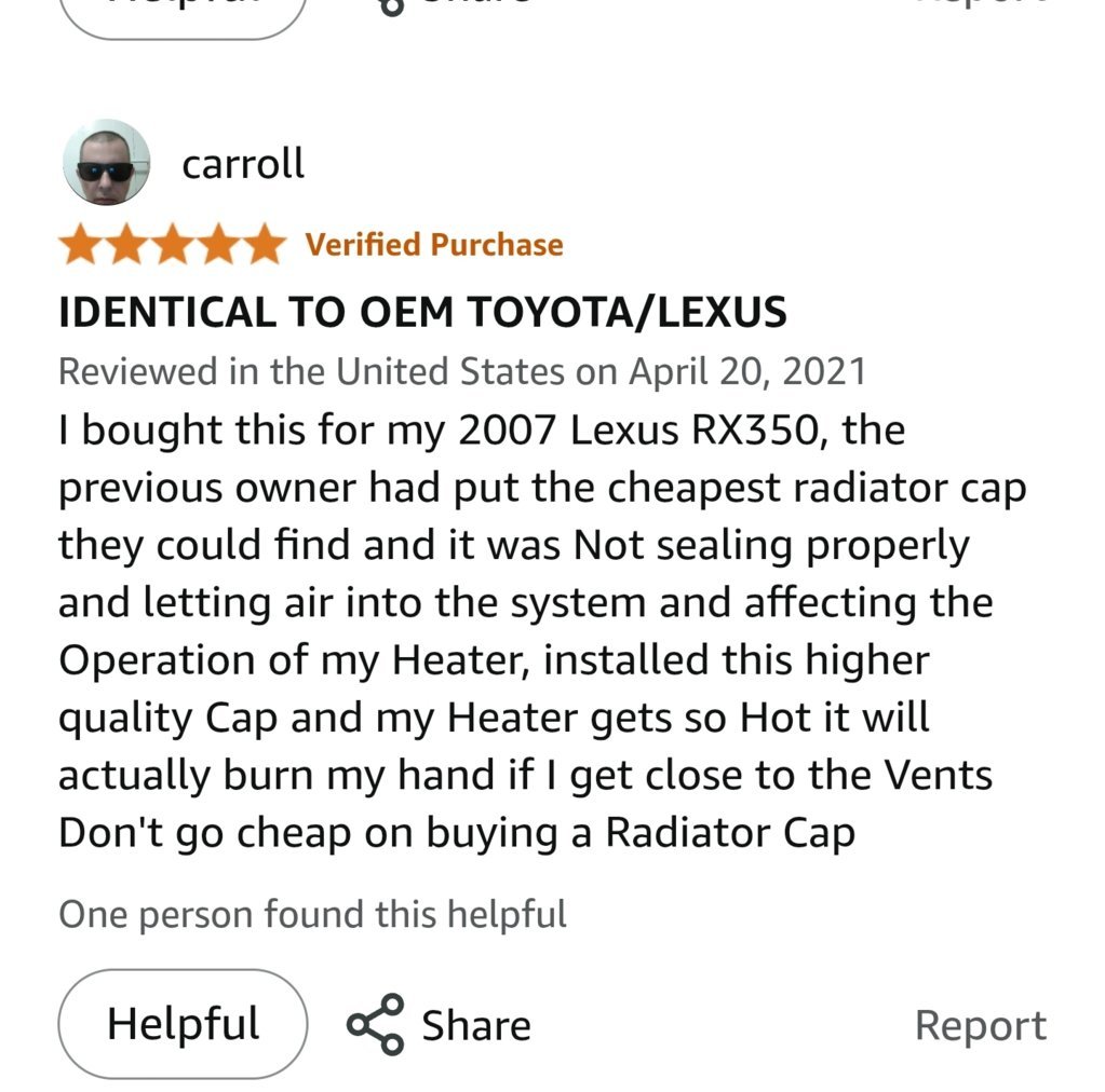

    Replace the radiator cap.

    It's just a guess. I'm in a preventive maintenance mode right now. I happen to read a review a few days ago about the radiator cap. They have rubber seals that wear out. Its a maintance item. It's cheap and should be swapped anyway so it's worth a try.
    Ps don't buy it on Amazon. Buy it your dealer or look up a direct quality fit at your local parts store. Don't get a universal one.

    The radiator cap has no bearing on any of this. Beyond keeping coolant from spilling, its only job is to raise system pressure in order to increase the fluid’s boiling point.
