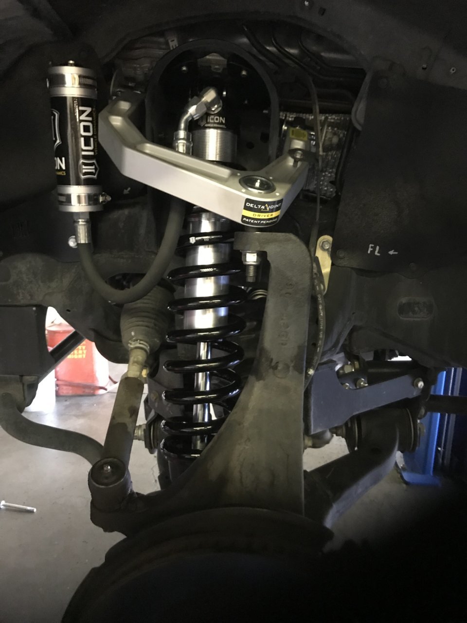

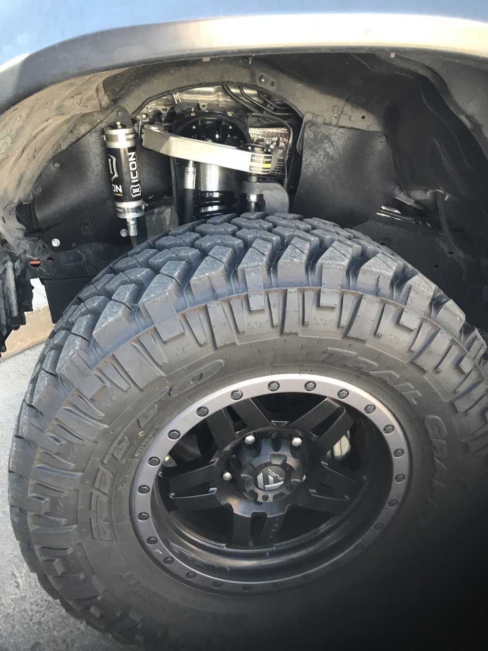

    6 inch Pro Comp lift. OME rear springs with Coach Builder +3 shackles. Coach Builder tie rod ends. ICON 2.5 front and rear shocks with remote res. ICON Hyd bump stops. 35" Nitto Trail Grapplers on 18" fuel rims. Kenwood DNX 892 head unit with JL audio and RF amp pushing 2 Image Dynamics idq10 subs. SABM, S POD switches for 42" in bumper and 32" behind grille LED light bars. Full interior and exterior LED conversion. LED flush mount back up lights in rear bumper. Valentine one radar detector. V Leds under dash and seats foot well lighting. TRD pro head lights and grille. Full AJT dash kit
    6 inch pro comp lift, no spacers or blocks, OME rear springs with coachbuilder shackles, ICON UCA's with ICON coil overs, highly recommend the coachbuilder tie rod ends to re gain turning radius and good alignment

    Nice rig what stage is that?

    Stage 4

    I have the Pro Comp Stage 1, I plan to do the same thing. How's the ride and stuff? I want to get rid of my rear blocks too. Looks good
    What's the part # on the shocks, I haven't seen the resi fronts listed for the Pro Comp?

    I got the pro comp stage 1 lift for a reason, it was the cheapest of the pro comps line, I wanted it that way because I was and did eventually upgrade the front and rear shocks to ICON's. I would not personally use any pro comp shocks or coil overs, I am a huge ICON fan. Also, getting rid of the rear blocks and using the coach builder shackles improved the ride 100 times over (I used OME springs) Night and day difference. The bump stops I added just for looks. I am in Arizona so I got all my stuff thru www.state48overland.com. The coch builder tie rod ends are highly recommended, you will get rid of that screeching sound your tires make when you are turning in a parking lot and will also re gain 30% of your lost turning radius. I was skeptical when they told me that but I went for it and they was 100% correct.

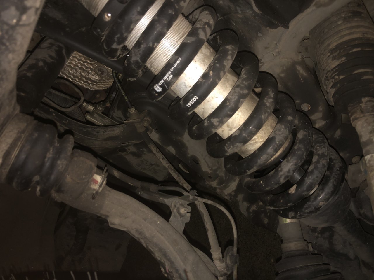

    I had the Icon stage one installed Weds. Haven't driven the truck much yet, but no doubt it is much more controlled feeling. It definitely takes speed bumps RR tracks etc much better. I will have the truck at the ranch this weekend,so will get a good feeling for it. I have the same setup on my 2006 Taco & it is & has been great.

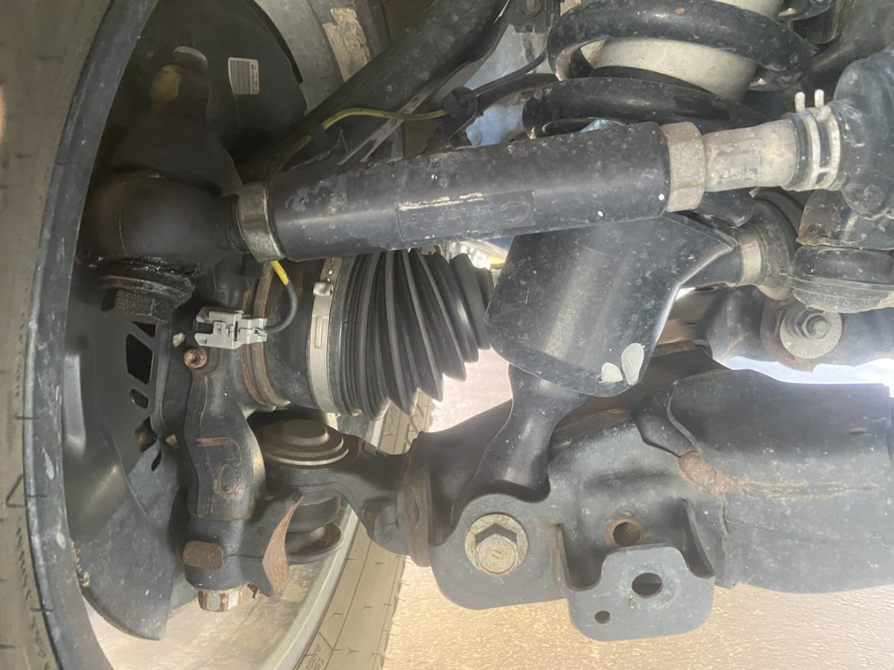

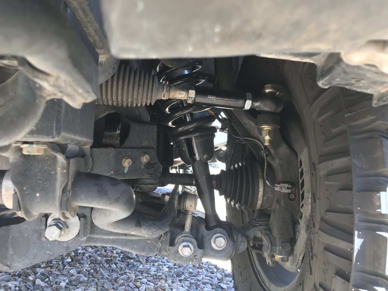

    My tire rod ends or at the bottom yours are at the top is there any difference is there a right or wrong way

    Not real sure. Had mine installed by a custom shop, alignment is perfect so all is good. I am on a pro comp 6 inch lift front spindles if that makes a difference. I do know the factory ends was on top.

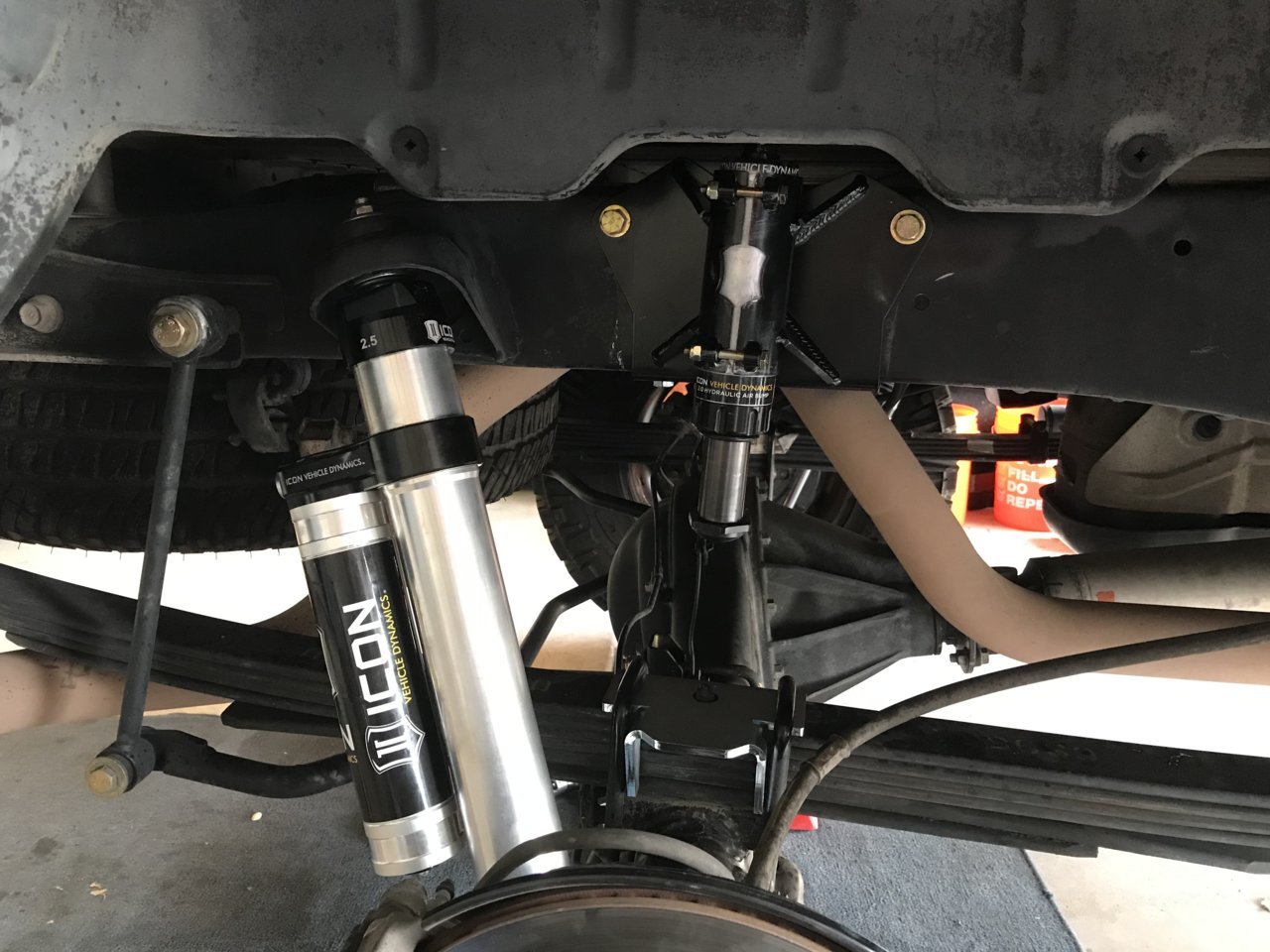

    I also have the Icon Stage 4 like Beaver but with a BDS lift.
    Question, what are folks using for bump stops in their rear? I am about to add custom Alcan leaf springs and want to add bump stops at the same time.
    Beaver mentioned he added the Icon hydraulic bumps... for looks. I was wondering if anyone else has run these +/- other aftermarket leaf mounted bump stops?
    Icon said they should work if I play with the size of leaf-mounted Bumps by playing with suspension cycle
    The Icon hydraulic bumps are pricey ($750) so if they are only for looks I do not want to drop that kind of cash.
    I had air bags on until now so I have no more factory bumps, looking to add something to work with my shocks (travel of shocks is matched to lift on the truck)
    Would love to hear what other 6-7" lifted trucks are handling rear bumps.
