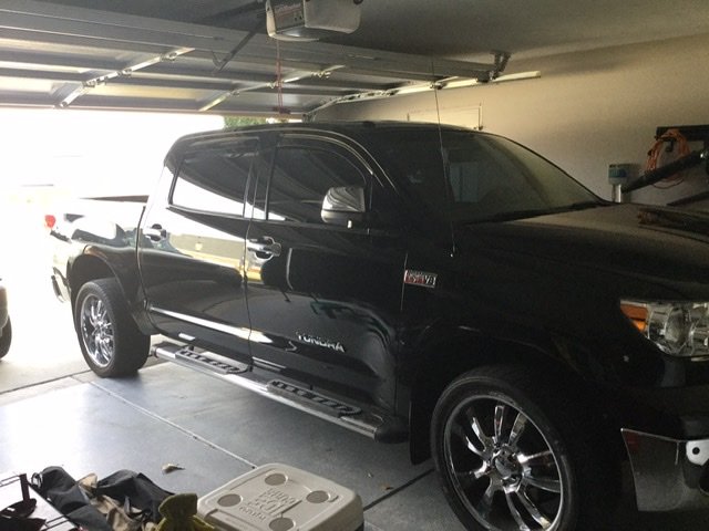

    Fellas after admiring all the different lift setup from the forum I’m now ready to take the plunge. First off, I know nothing about off-roading or lifts. I simply love the way they look, but have no idea what height I should go or setup. I want to keep my current rims and tires(305/45R22 Nitto Terra Grapplers). What is the best setup without breaking the bank and needing a ladder. Who knows! I might just start off-roaring. 33C14380-42C5-4FD1-90F1-C05129B61418.jpg

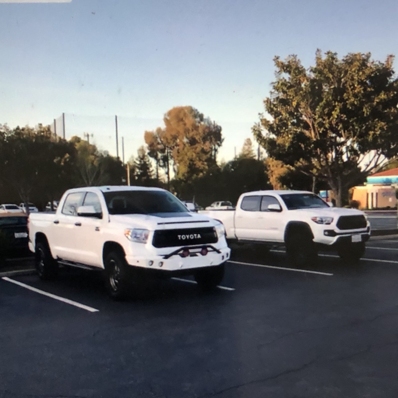

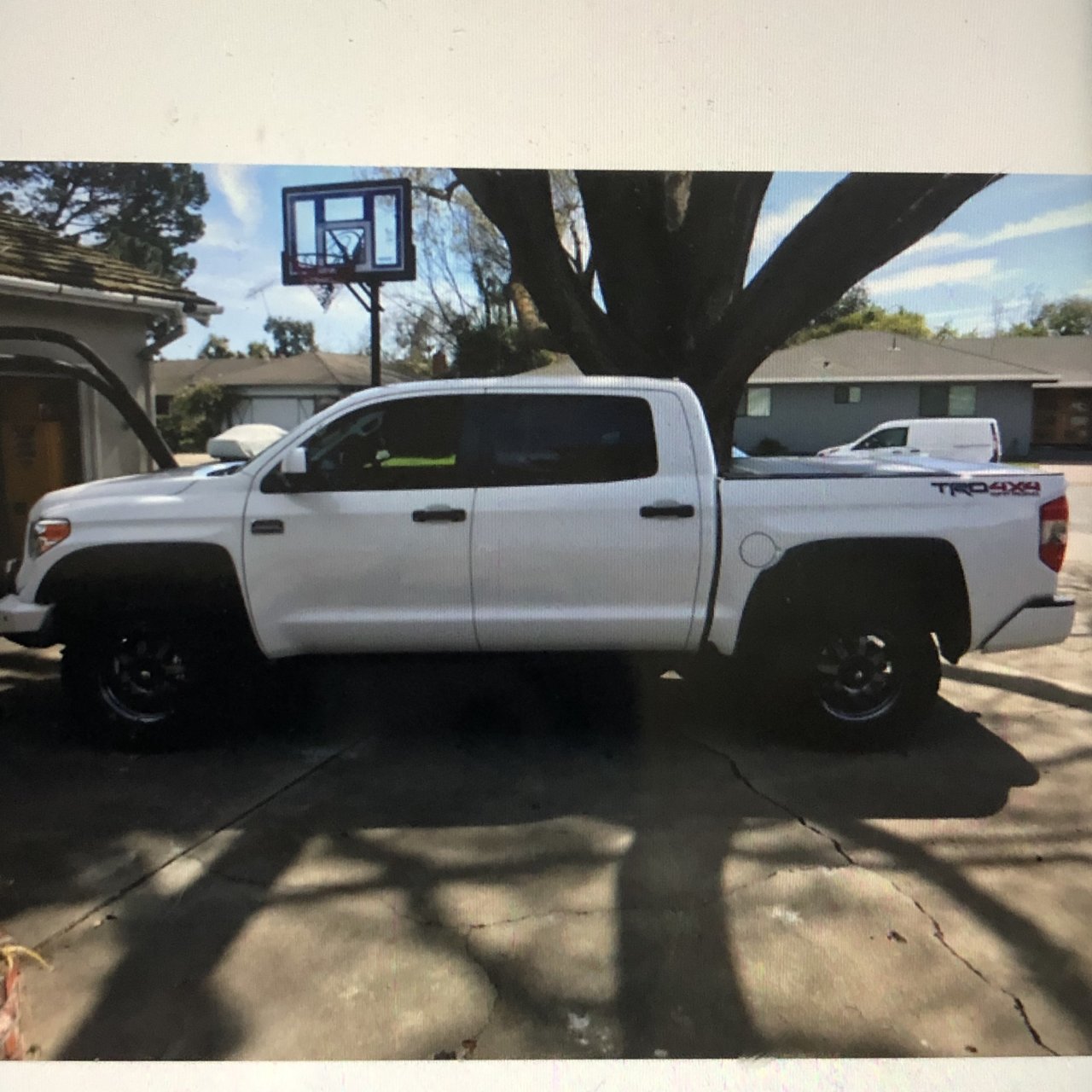

    I had a 3/1 lift from Toytec in my first Tundra. I also had 20” wheels with 285 65r 20 BFG KO2s
    The lift I bought had 700 lb springs because I had a winch style bumper (DV8) I spent about 1300.00 on the lift. You might consider 650 lb springs, it won’t be as stiff and don’t put the struts at the top settings, (if you by adjustable ones) for your truck. The pictures (my old truck) I included were mimics of a lot of trucks on this site. You may need shims that bolt on the top of the new strut you buy to keep it level,
    Or not to have some take on the front compared to the back, just depends on the look and ride your going after. Looking back on my old 1794 CM , I would have done things differently. Like buying smaller rims that would except a taller sidewall. That side wall helps the ride, and cushion the ride.
    I got so caught up in”filling the hole” I’m referring to the wheel opening to tire size, and how it looks. What you want and how it turns out may not be what you had originally intended to be. With your existing rims 22” ( a very narrow sidewall tire) and a stiff lift kit may not be how you want it to ride like.
    My next truck will be modded quite a bit differently. I just need mo money lol.
    I’ve heard this said on this site many times, “buy once, cry once”
    Meaning spend your money wisely and you happy and like me change direction and spend again in a different direction. I hope this helps you in making decisions on mods. This site has many wonderful people and ideas, but pay attention, we all make mistakes. We all want badass, but we may sacrifice something to get that. That something could be an important item that doesn’t work well with the other items we bought. Bla bla bla. Hope you’re on the same page as me.
    again good luck to you and your build.
