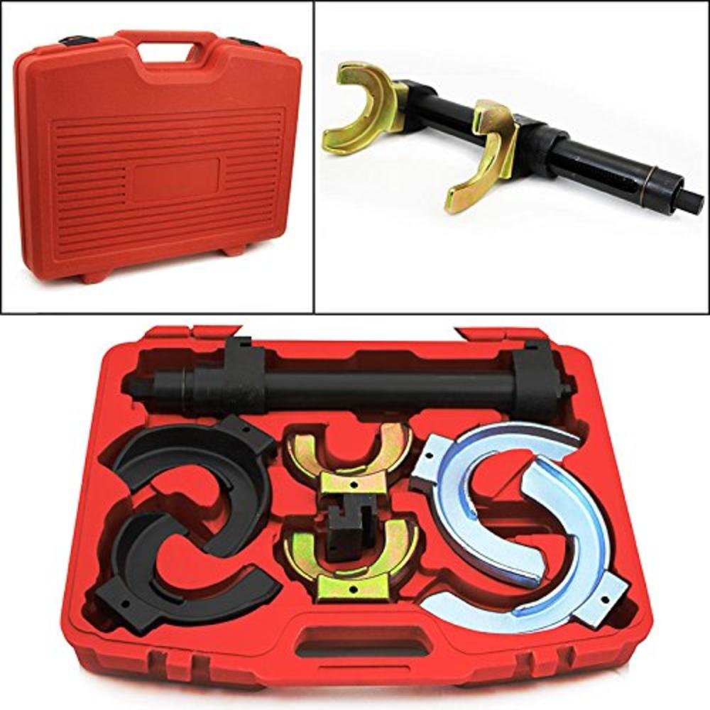

    Would it be beneficial to install a spring compressor while the wheel is on the ground (slightly compressed) and THEN raise the truck so the wheel droops but the spring stays compressed?
    Something like this:

    @DividedSky I always take the shock out of the truck using spring compressor and make the adjustment. To me a lot easier this way.
    This is what I use.

    I was able to compress the springs enough to adjust on the truck. The spring compressors you posted need to have some of the lip ground off to fit between the King coils. It's a little tricky but I was able to figure it out. The King punch tool is too large to make complete turns once you get to the portion where the allen bolt is - so I had to use a shorter piece of metal and a rubber mallet.

    I didn't even think of installing the compressors while the truck weight compressed the coils. Not a bad idea
