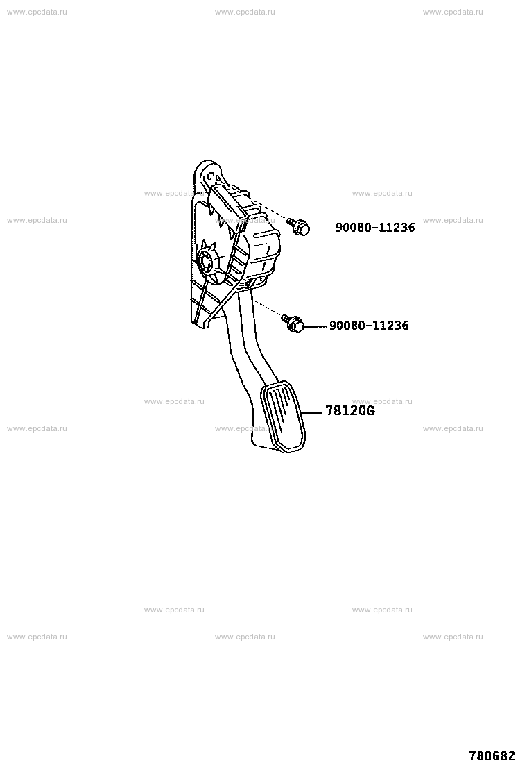

    I'm pretty sure it's possible to adjust the throttle position sensor and/or throttle plate, isn't it? I swore I saw a reset process on that, but strapped for time and can't look.
    I'm wondering if OP's may be tuned poorly so a slight tap of the pedal puts the truck @ WOT or something.

    I've looked at videos to adjust the throttle positioning sensor. Thankfully, appears very easy (after double checking the area of it on my Tundra) to do but would like some input from someone who understands these gizmos to say yay or nay on that is what I need to be targeting to lessen my need for non egg breaking control on the gas pedal.

    Video I looked at for the TPS showed moveability/adjustability due to slotted bolt holes rather than round holes. But they are talking using a voltmeter (which I have 2-3 of) to do the adjustment , but I'm lacking in the understanding of electronics, and the total function of "this" sensor. Mechanics, for me tends to be straight forward and "see-able". Not so with electricity, especially when they use it to move things mechanically.
    shifty`[QUOTED] likes this.

    I believe (90% certain) that the TPS is NOT replaceable this version of the throttle body.

    A video I watched for the TPS shows adjustability in the body due to slotted bolt holes, rather than round holes. I'm mechanically inclined, not electric inclined, so hesitant to be changing electric signals without a fair understanding of the result from my adjustments. And yeah, I have volt meters to give me readings of that electricity, that I don't understand all that well.
    Not at all convinced it is a throttle body or gas pedal needing cleaned. More the need to change the point where it jumps into ramming speed!

    From the video above, at least some of the throttle body are serviceable.
