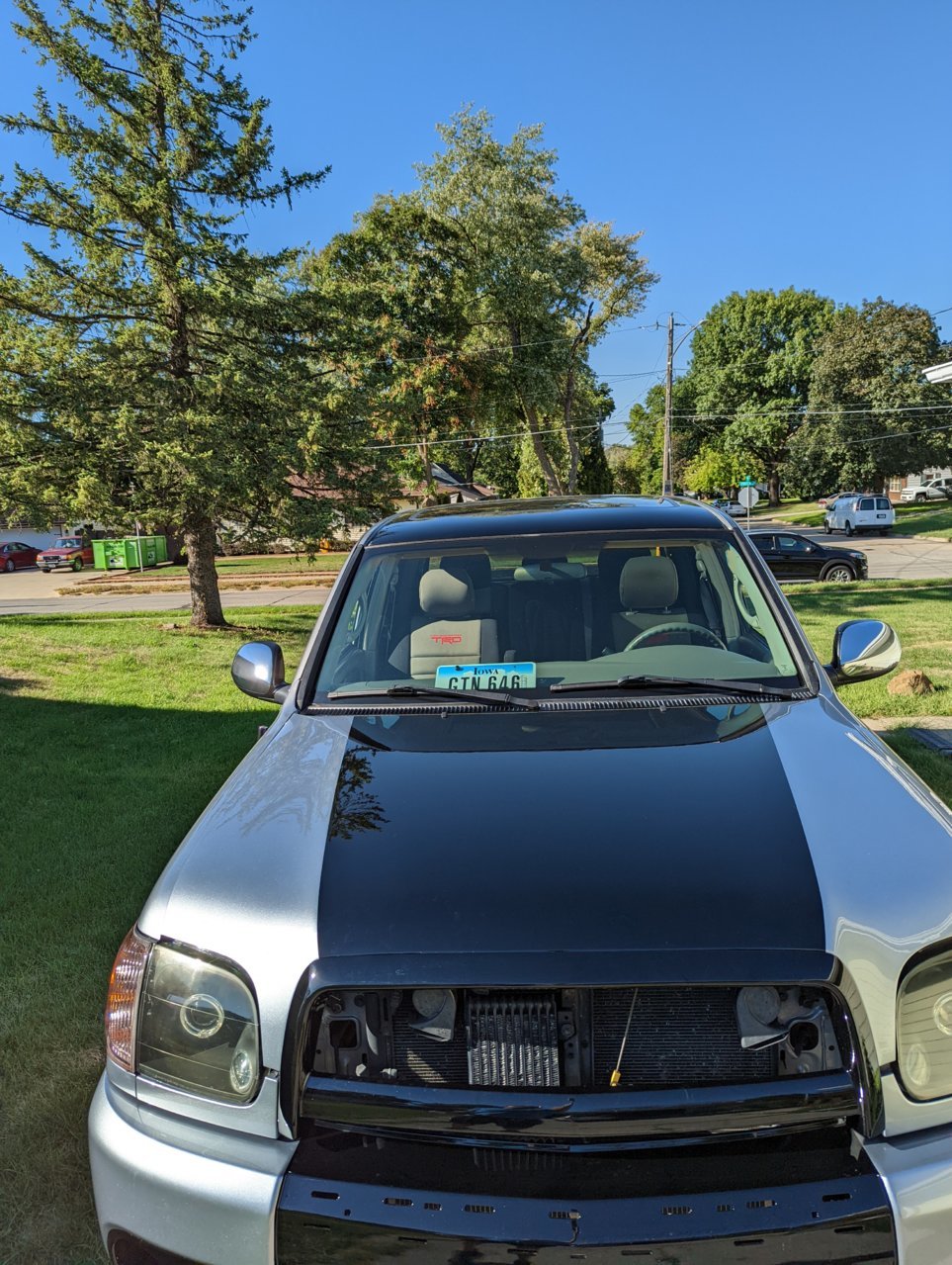

    My truck is finally being painted. The front roof and back of cab anyway...I've looked around on the interwebs and it seems theres all sorts of waiting times.
    Question is how long after paint does one have to wait to polish etc. And coat a vehicle? Are there any autobody techs/painters here?

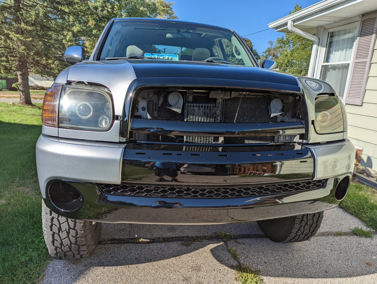

    Yeah, I figured as much. Before @Ginsterkev chimed in I was just gonna call and ask. But him being a painter and his response sounded solid and logical. The guy that did the work said he'd wait atleast a month when I picked it up yesterday. I figure wtf is another 2 after that. Better to be safe than sorry. Guess this way I have more time to figure out which coating I wanna try out. Leaning towards Undrdog because it seems so user friendly but I'm also trying to find a way to mitigate the risk of the rock chips that just got removed....I don't know if the "hardness" of any coatings will even help that. PPF on the front is an option but I'm gonna need some practice prior to that whole hood and bumper.
