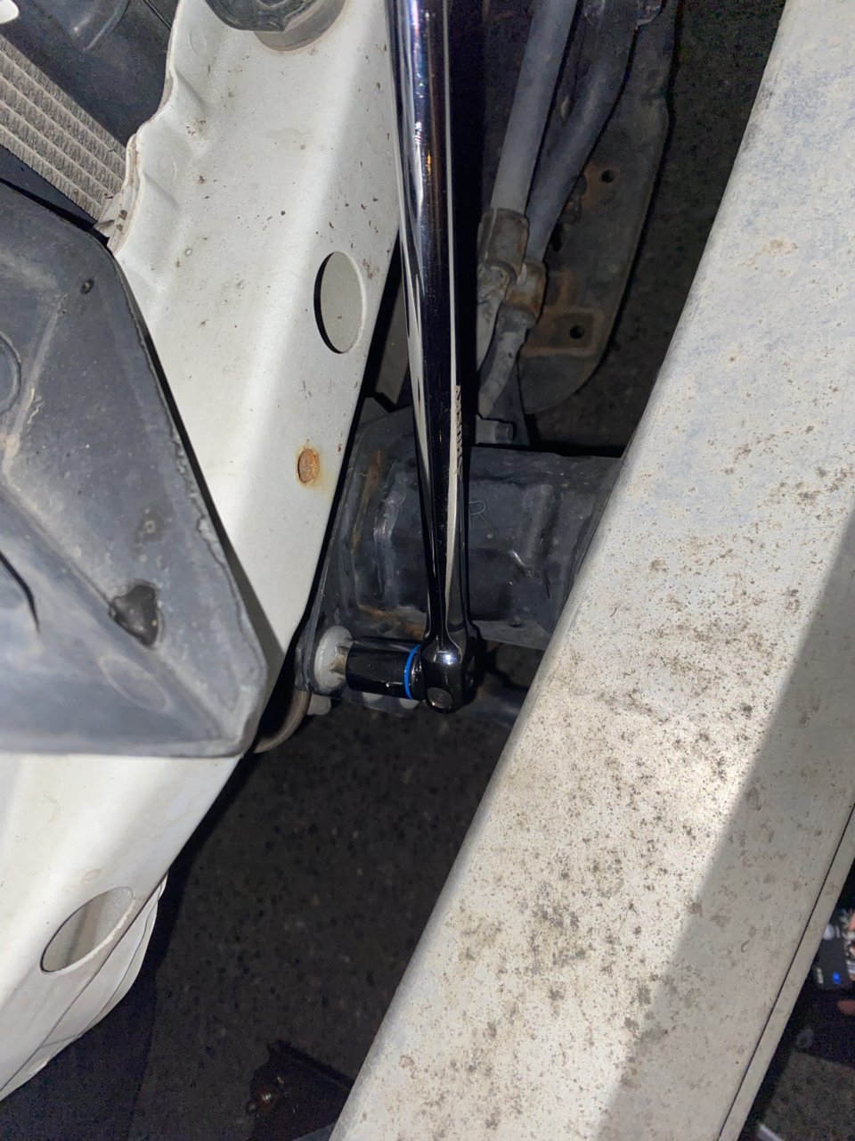

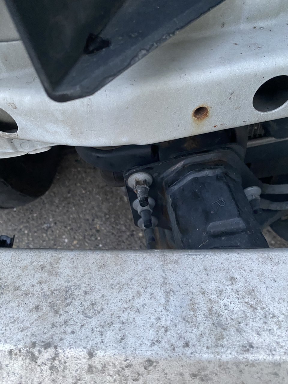

    I've been trying to put lightbar mounts on my Tundra for two years. I have the whole front end disassembled but cannot get the one last top nut off the frame rail that the crash bar mounts to, in order to attach the light bar mount. It's a 14mm, and i have a regular socket that's just barely too short to get around the nut and attach to my breaker bar, and a deep socket that is too long for me to fit my breaker bar in the space. I've seen guys get this bolt off before. What am i supposed to do? It's almost 9pm and I just want to finish this. Thanks in advance.

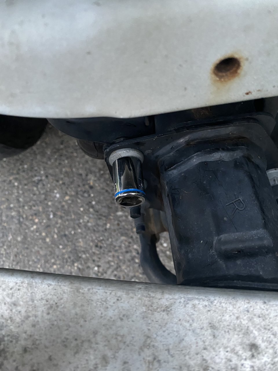

  8. Jul 31, 2022 at 9:19 PM
    SNO BUS
    SNO BUS [OP] Professional Moneywaster
    Feb 17, 2018
    #12980
    333
    Nick
    Washington
    White '18 CM 4x4 Limited+
    LEER Canopy, Line-X, Bed mat, Wireless charging
    Correct. No way to get impact or even socket wrench/breaker bar back there because thread is too long and socket is too short or long. Box end wrench w/ cheater bar may be on to something... i'm thinking propane torch combined with that?

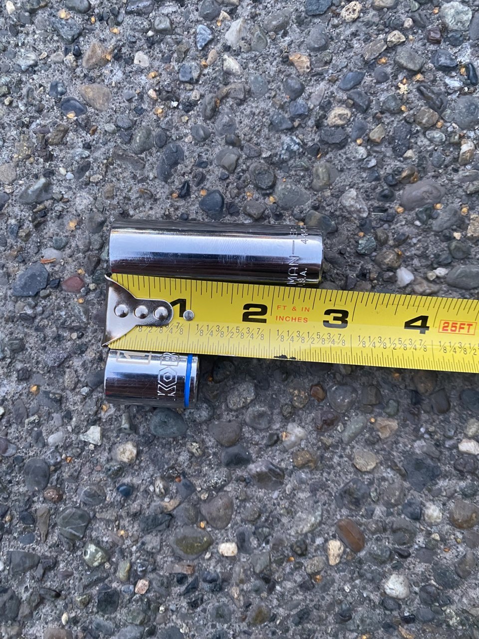

    SNO BUS
    Feb 17, 2018
    #12980
    333
    Nick
    Washington

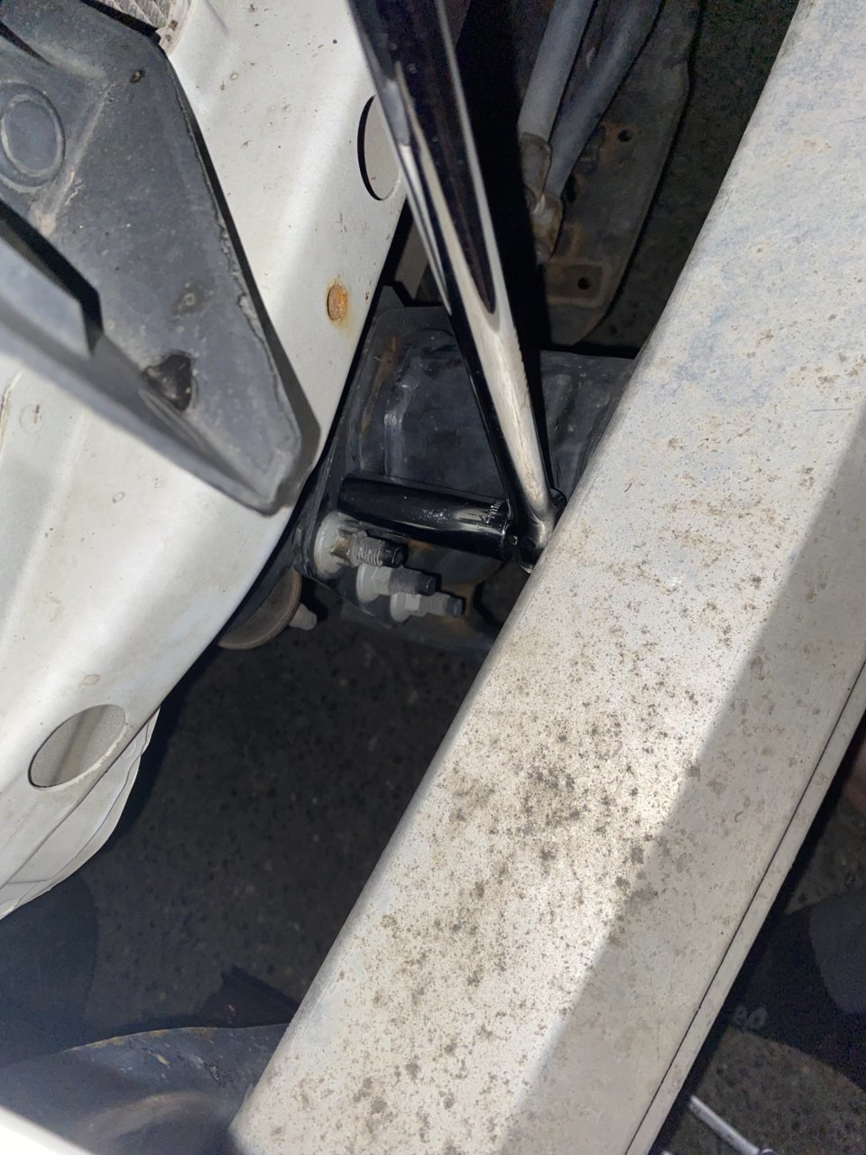

    More perspective. Breaker bar with regular 14mm and then breaker bar with deep 14mm. Regular 14mm too short to get onto nut, long 14mm cant fit with breaker bar in the space. Therefore, i don't think I'd be able to attach a u-joint to the deep socket either.
  13. Jul 31, 2022 at 9:26 PM
    SNO BUS
    Feb 17, 2018
    #12980
    333
    Nick
    Washington
    Mid-deep socket would be the trick. I think. I have a friend with a 1 1/2" 14mm deep socket, while my regular is 1" and my deep is 2 1/2". May pick it up tonight. As well as a torch.

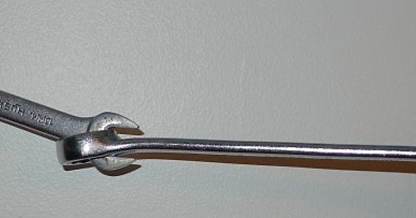

  14. Jul 31, 2022 at 9:26 PM
    Joe333x
    Joe333x Member
    Apr 4, 2019
    #28632
    1,910
    Boston
    2019 Tundra CrewMax Platinum

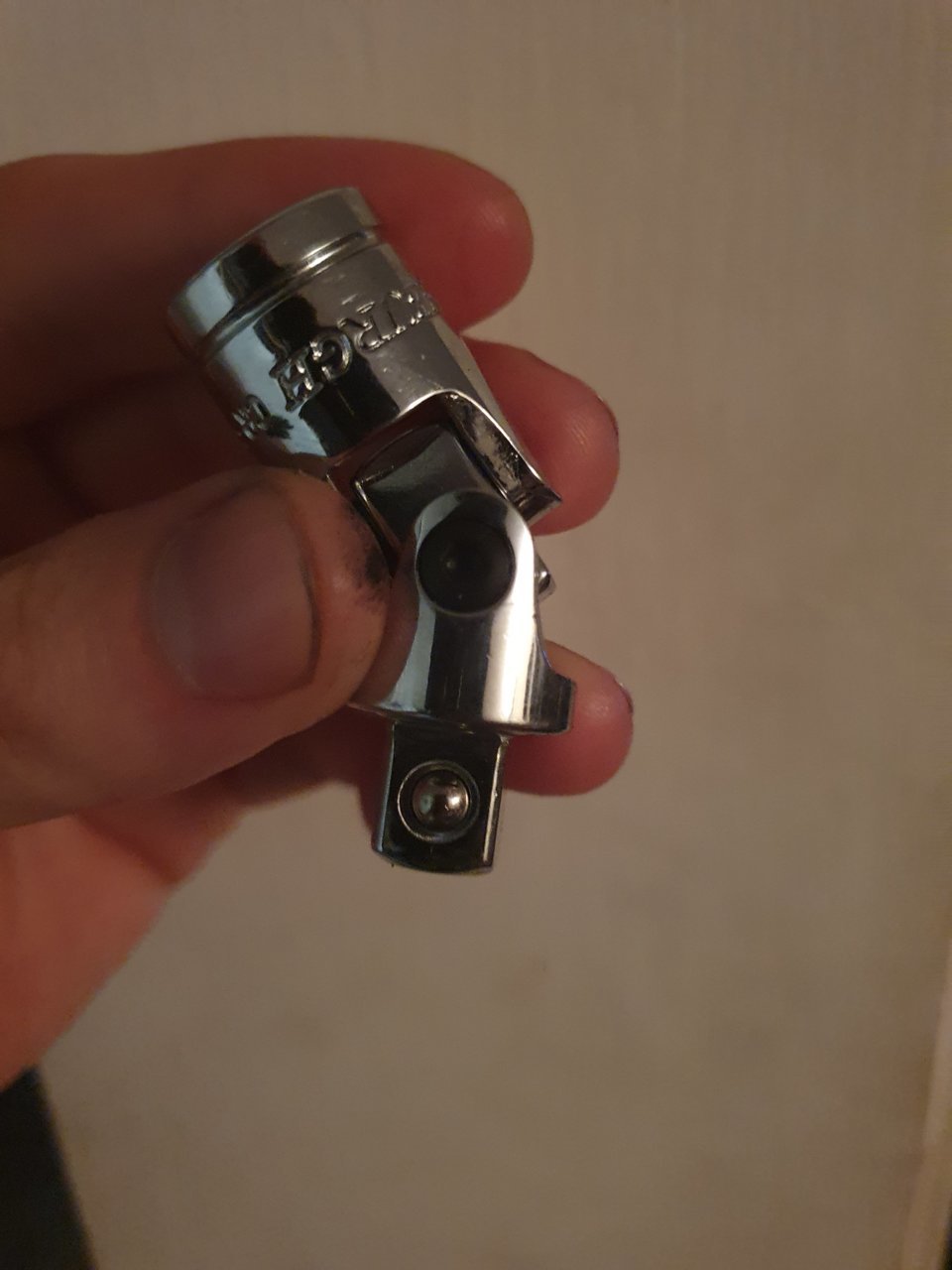

    What about one of these?
    Tripleconpanna likes this.

    Don't think it would fit on a deep socket back there. Cant even fit my breaker bar and deep socket. See message I just posted about my friend having a socket in between the two sizes i have.

    That will be dire straits solution. But i've seen pics of guys installing their lightbars here before with the bolt happily off. No grinding.

  22. Jul 31, 2022 at 9:39 PM
    SNO BUS
    Feb 17, 2018
    #12980
    333
    Nick
    Washington

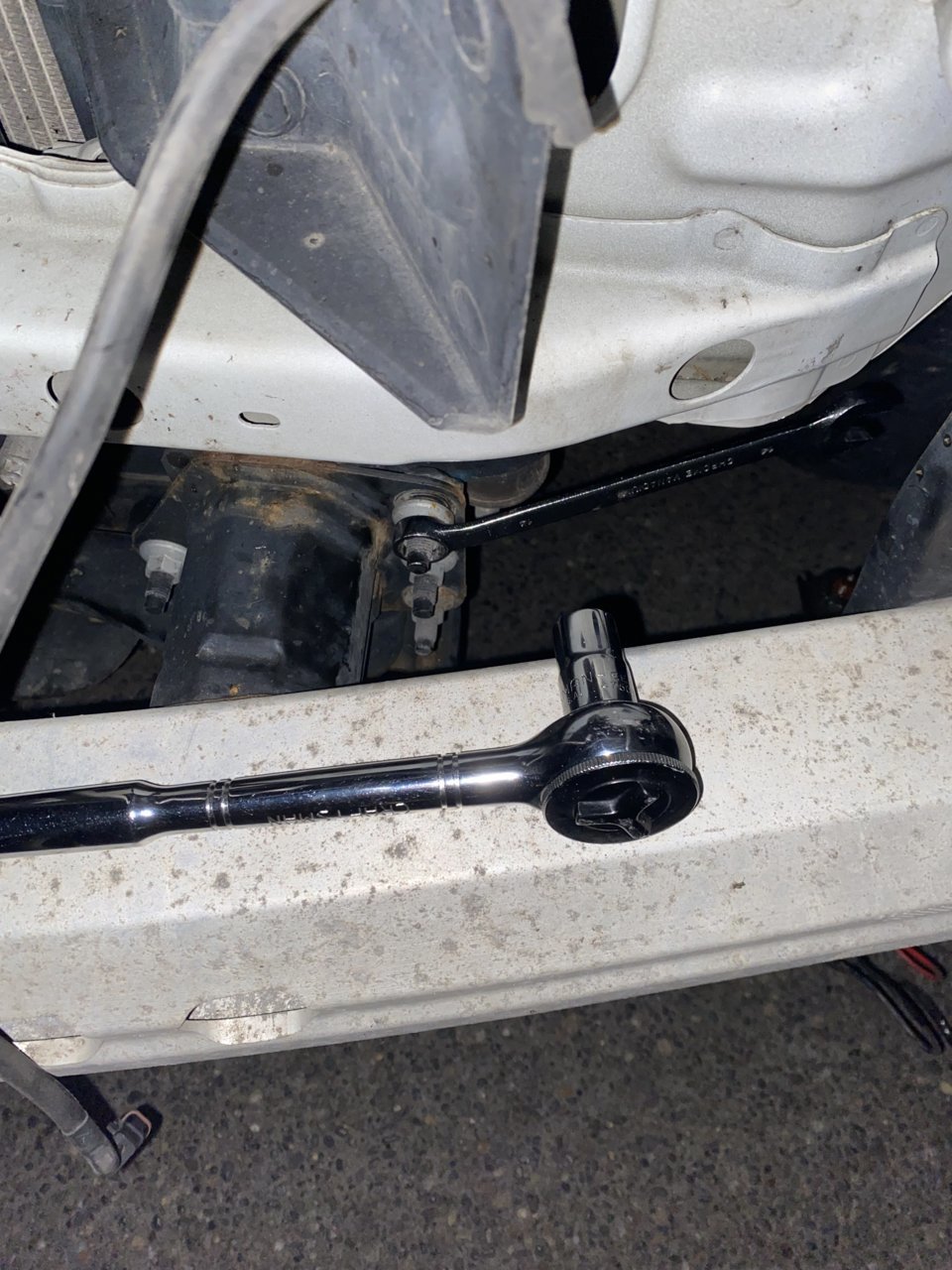

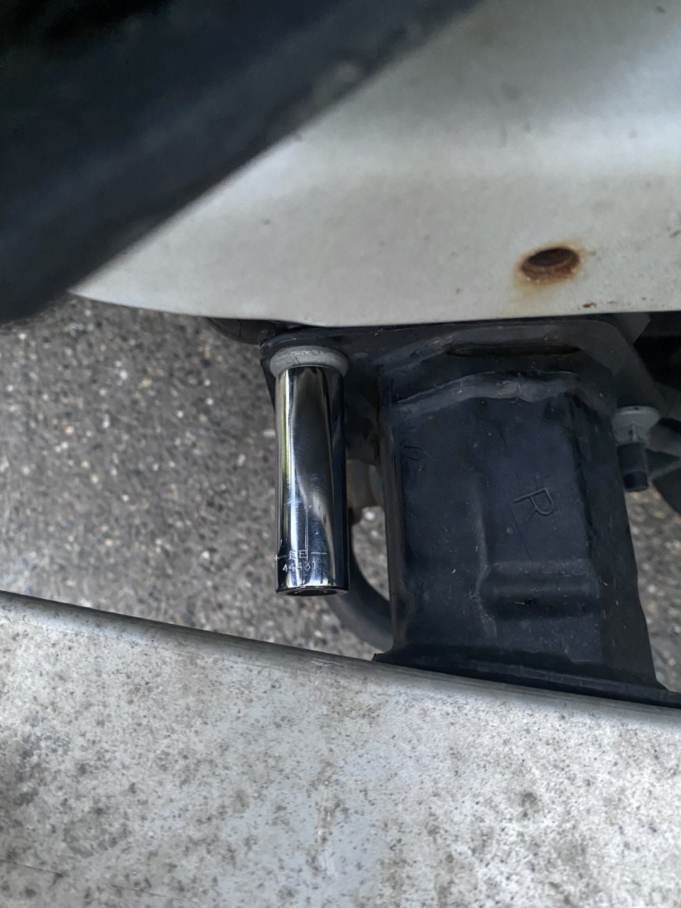

    Got it! I don't have a 14mm "mid-deep" socket but I do have a 9/16" mid-deep socket which is close enough to 14mm. Stuck it on there with regular socket wrench and it came loose no problem. Now just have to thread it off the rest of the way with small wrench turns which will take all night because i don't have ratcheting wrenches but oh well.

    late to post but I took mine off at this exact same place. I used a 1/2 drive ratchet and a middle deep socket no problem. I had one in my craftsman kit that worked perfectly. Then just thread it off by hand once loose.

    Yes. 14mm ratcheting wrench and a 14mm mid-deep socket would've made life a lot easier. Also, the 9/16" trick was ok but I realized I had to remove the whole crash bar and bumper to easily accomplish what i wanted to and I am not sure the 9/16" mid-deep socket wouldve been easy there. Also didn't want to try to torque bolts back down using a 9/16". I got the rest of the bolts off (and back on) double-wrench cheater bar style no problem. Then had to use a standard 14mm wrench painfully slowly to back the nut away from the bolt enough to slip a regular 14mm socket on and go the rest of the way. Patience is key.
