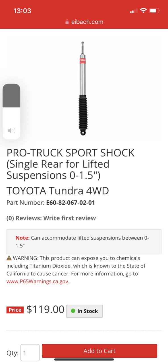

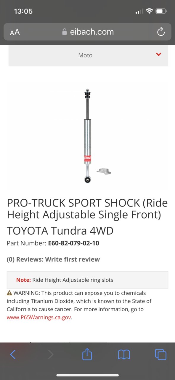

    Can you provide the Eibach part number?

    Coach Builder 1 inch lift strut spacers Coach Builder 1 inch shackles TRD Sway Bar Diode Dynamics SS
    IowaGuy[OP] likes this.
