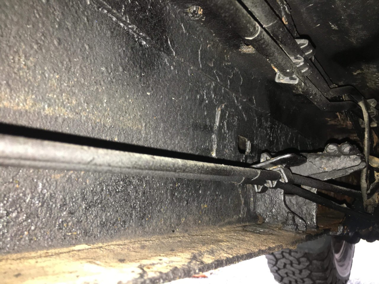

    Thanks in advance all! Looking at a 05 trd limited with 149k for 11,500 that’s had a professional undercoating. How’s it look to you fellas? sorry I don’t have pics of it on a lift.

    It appears clean. What type of undercoat? If they used a certain undercoat like zeibart stay clear. It traps moisture and will rot from the inside out

    Looks great. So do the shocks. Is that woolwax on there? Or some rubber "stuff"

    Kinda looks like they may have went over existing rust. Looks like some flakes or what have you. Where the metal basically separate and sheets apart. Hard to tell from pictures. I'd be concerned with the boxed in portion/ front of frame. There's evidence of rust in that picture. I'd poke around at it if they let ya. If not walk away. Doesn't look as smooth as I think it should if the metal was good before the application.

    Those bubbly areas huh. There seems to be hints of orange peeking through here and there as well.

    I can't say the frame has any rust penetration issues, but it definately has rust on it that they simply covered over with that undercoating. And it appears to be "paint-type" vs a "fluid/oil" type of coating -- which is a problem. If you're going to paint something, you have to remove all the rust.

    Thanks all, I’m from northern Vermont and the truck is in NY and 5 hrs away. The undercoat was put on in 2018. I’ve asked for a few more pictures to see the other side of the frame and the rocker panels. Owner has said there is some surface rust but no rot. Only way to get a clean frame around here is if it has a new frame, but the last two new frame tundras I looked at had body rot... if this one is a no go I may wait till the summer when I can travel across country to get one.

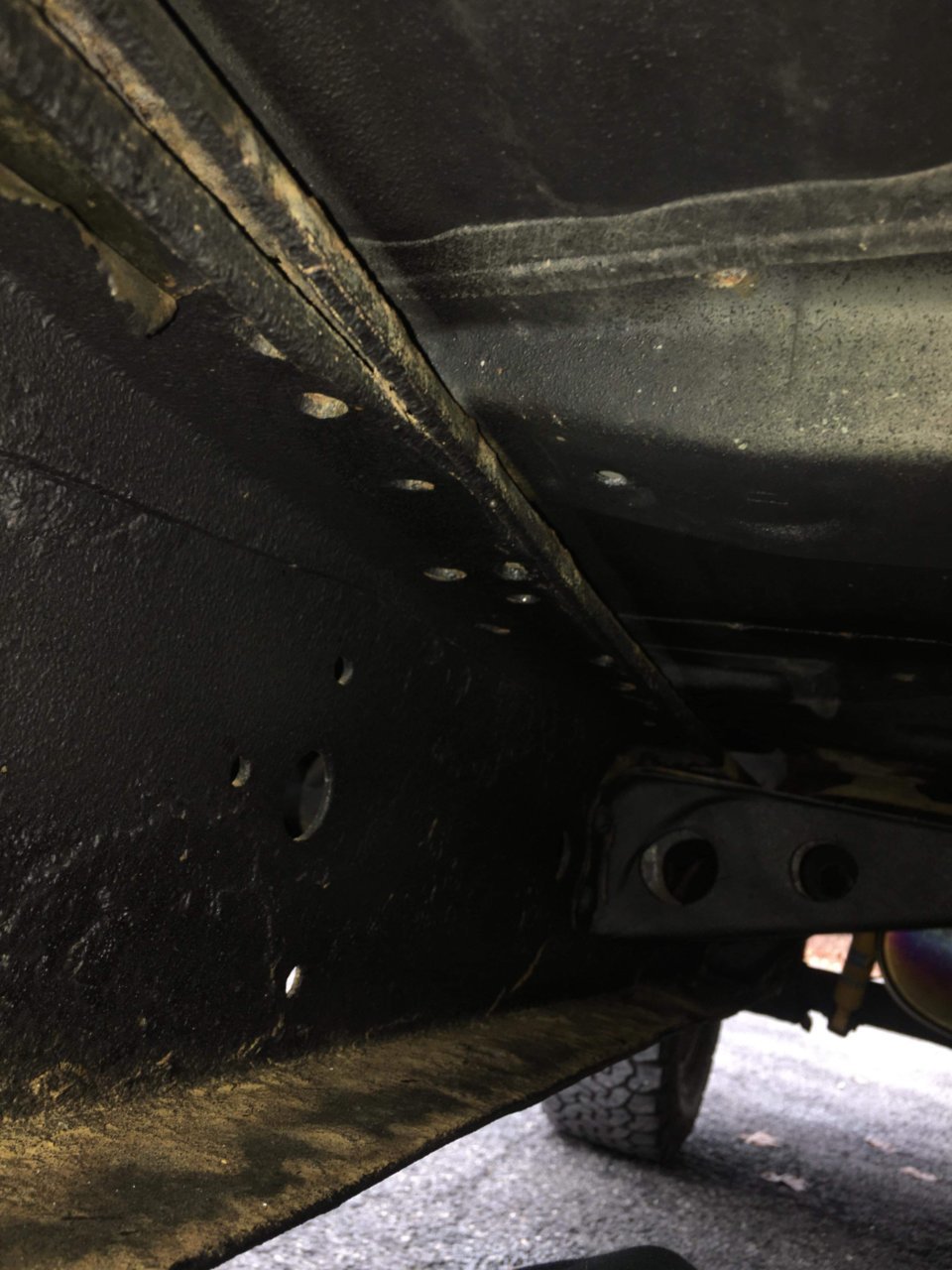

    Thanks again all! I got some more pictures from the seller and it looks like he’s spray painted everything, and the rust is still showing through. I don’t think it’s worth a day drive just to be disappointed

    Keep looking... you're better off without that truck. Especially at the price he's asking. Mine was rough, but I got it cheap, and was confident in repairing it.

    So...I had to go see it, went with cash just in case but with no intention to buy unless I was pleasantly surprised. And it will be no surprise to any of you it was a complete rust bucket underneath. The rest of the truck was pure mint and it was so hard to stomach. Owner let me spot check and peel off some undercoating, which turned out to be a rubberized undercoating. With the undercoating came layer after layer of frame. I could not find a single exposed piece of metal that was not rusted.
    For the life of your trucks please don’t use rubberized undercoating. There was one or two spots where the owners application of undercoat did not cover the Toyota recall spray and those spots were just fine. In 4 years that rubber undercoat has destroyed the truck.....(assuming the recall undercoat service did its job.

    Yeah, folks learned in the 80s & 90s that rubberized undercoating was a disaster. Unfortunately, it still persists.
    The Toyota spray was not a legitimate solution -- they should have been sued over that. They knew they had a problem, and the spray just bought them a few years.
