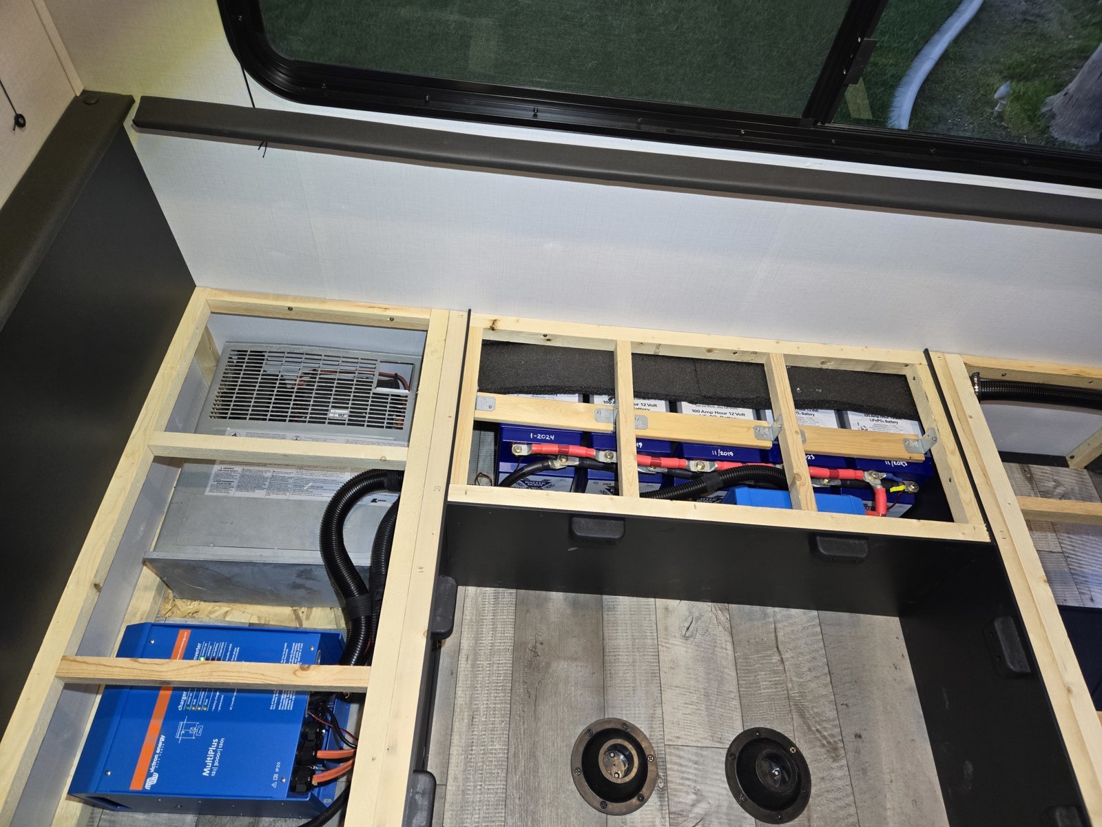

    You are correct. I did this setup in my travel trailer. Victron Multiplus 3000, fed by (at the time) three Battle Born LiPo 100 AH batteries. Made two mistakes: 1) using Amazon "chinesium" bus bars, and 2) 4 AWG wire.
    Powering a microwave oven and coffee maker burned the bus bars and melted the insulation off the wiring. Was lucky nothing caught on fire.
    My setup now has 4/0 AWG with a Victron 1000A bus bar. No issues, all works great even with five Battle Born batteries!
    OP is right to want the heavy stuff but IMO it's a waste in the truck. Recharging is important- even with 500 AH I can't sustain a microwave/AC/coffee maker for very long. The truck isn't going to do that, so you'll need a generator to do the recharge.

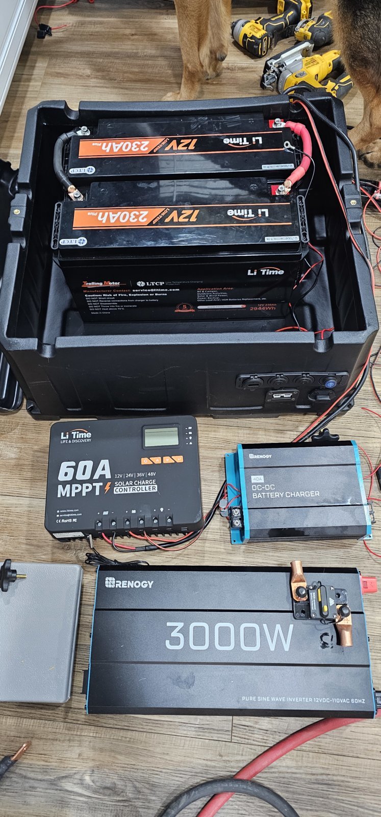

    Thank you! I'm enclosing a photo of the setup (minus the 40 amp AC to DC charger. And every time I write that, I start humming "Thunderstruck" ) I'm running the same as you on the 600w panels, but I will probably add another Renogy 400 watt combo. If I ever add a camper with A/C to the mix, I'll need a LOT more batteries.
