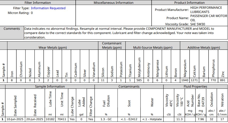

    I don't think it is necessary at all.
    Yes, most of your wear occurs on start up, but I'll show you my last UOA, 10.2k miles with miles to spare. Notice the extremely low wear metals. If you added a pre oiler, how much more could you bring these numbers down? And would it be worth it? I don't think it is. Wear is also linear, so the longer you run your oil, the more wear metals show up as evidenced by many UOA on bitog. The oils I like also have lots of moly, which essentially "plate" the internals of the engine with a super slick, super tough (500k psi) barrier.
    The Schaeffers has been great, but im switching to HPL products as they have much better additive pack, extended drain intervals of 20-25k, and they have alot of Ester in the oil which cleans your engine extremely well of any sludge or varnish, and its my opinion that it will keep the timing chain tensioner from getting dirty, sludged, or clogged, and keep it in good working order. I priced a case of 4 gallons and it equals around $10qt.

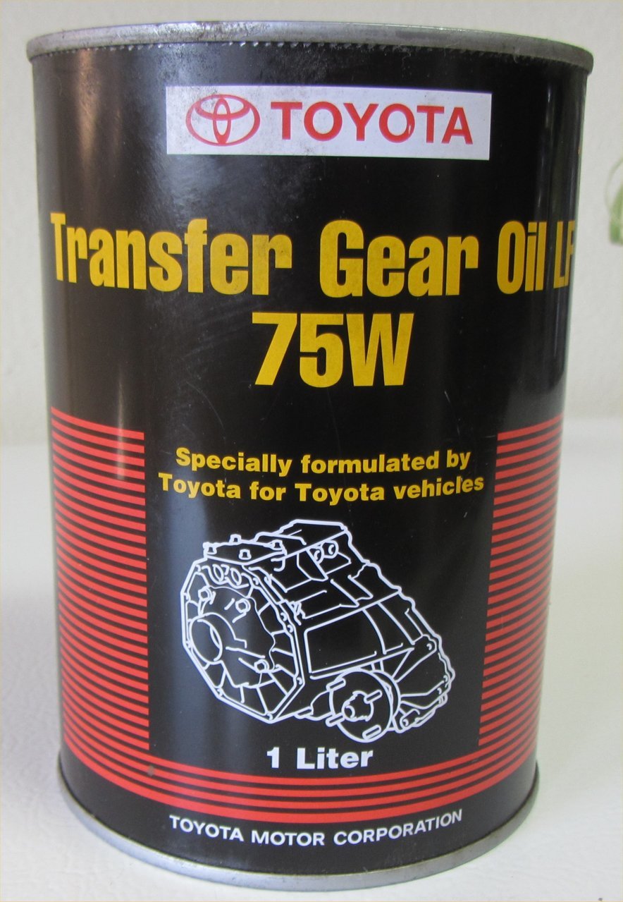

    Many
    This is the only thing that Toyota recommends for their transfer cases...
    It ain't cheap but it's cheaper than have to replace a transfer case because you used the wrong fluid....
