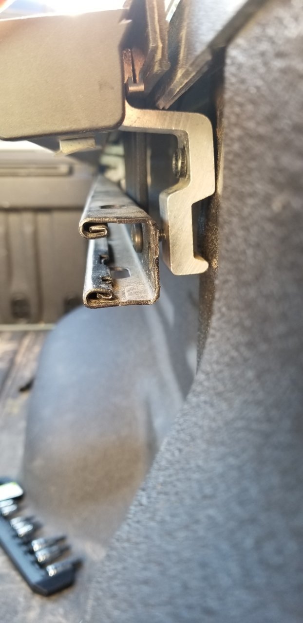

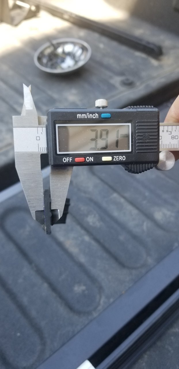

    During my first attempt to install the crossbars I had two major issues.
    1. The crossbars didn't fit under my tonnaue cover system without having issues with using the cover. The major issue was that the uprights pushed the cover rail system in to far and the cover would not fit back on properly. If you look at the picture, it shows how the uprights pushed in the rail system about 7mm total. This was enough to miss-align the cover and the front locking mechanism didn't lock back into place.

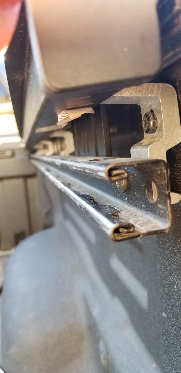

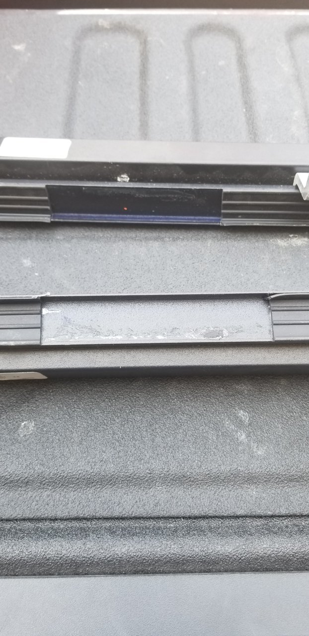

    To solve for this I had to cut out the weather stripping that is stuck onto the tonnaue cover rail system. The weather stripping measures almost 4mm each so taking out the stripping on both sides gave the cover rail system enough room to fit almost normal.
    Weather stripping cut out to make room for uprights.

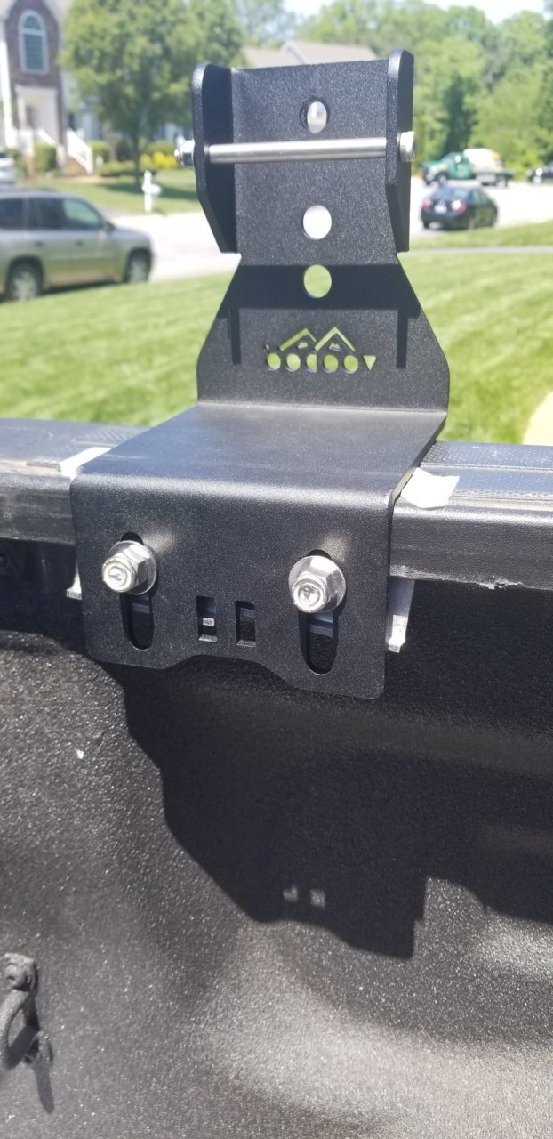

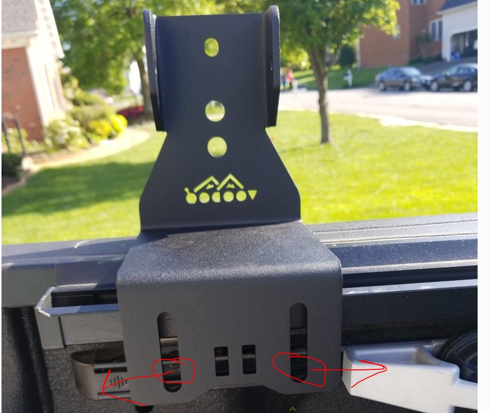

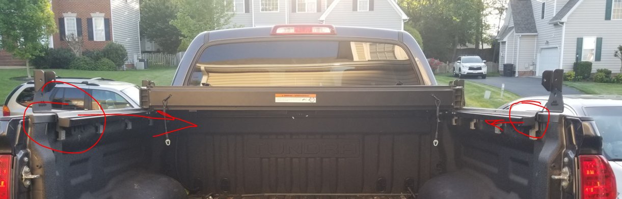

    2. My second issues was the uprights didn't align with the accessory rail and actually got in the way of reinstalling the rail.
    In this picture, there was no way to bolt the uprights to the accessory rail system because they were relocated.
    Uprights stuck out far to reinstall them without some spacers.
    To get around this, I had to order the no drill clips which install by bolting/pressing the uprights to the underside of the bed.

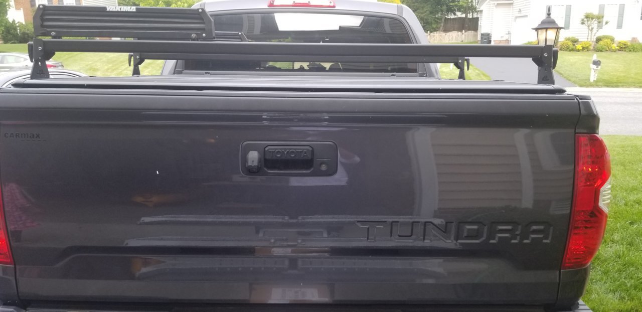

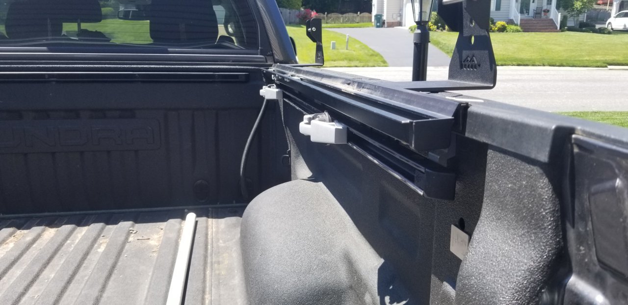

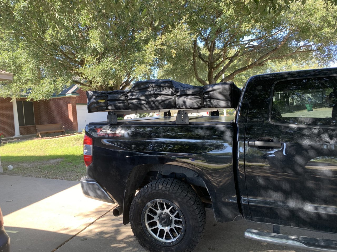

    This picture shows the uprights install with the tonnaue cover system and factory accessory rail back in place.
    In all, with trying to figure this out and going back and forth to HD for bolts and spacers, this took me about 6 hours. Most of the time was spent trying to figure out fitting.
