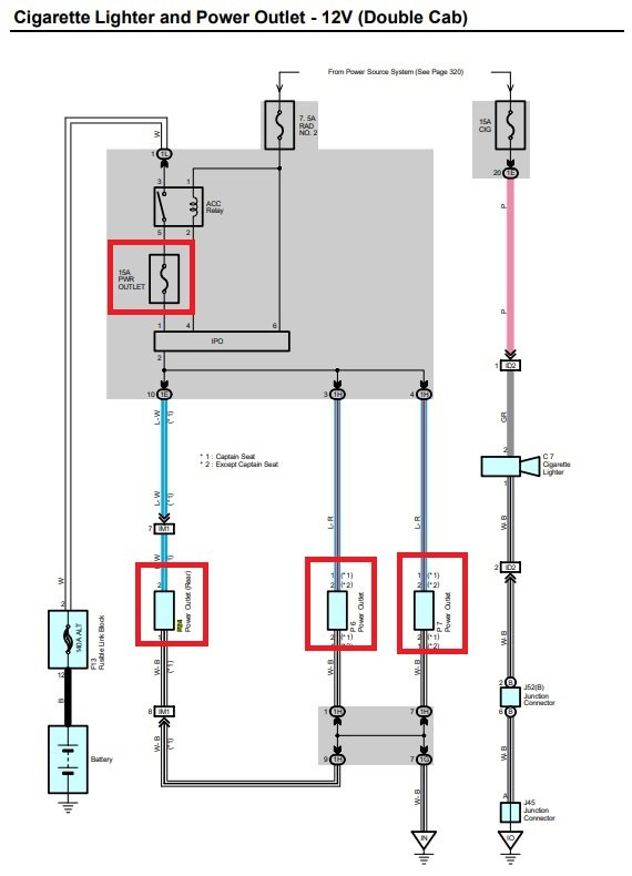

    If you are referring to the cig lighter outlet, that is protected by the 15A Cig fuse.
    Those two 12vdc outlets are protected by a 15A Pwr Outlet fuse located in driver side Instrument Panel J/B for your year DC.

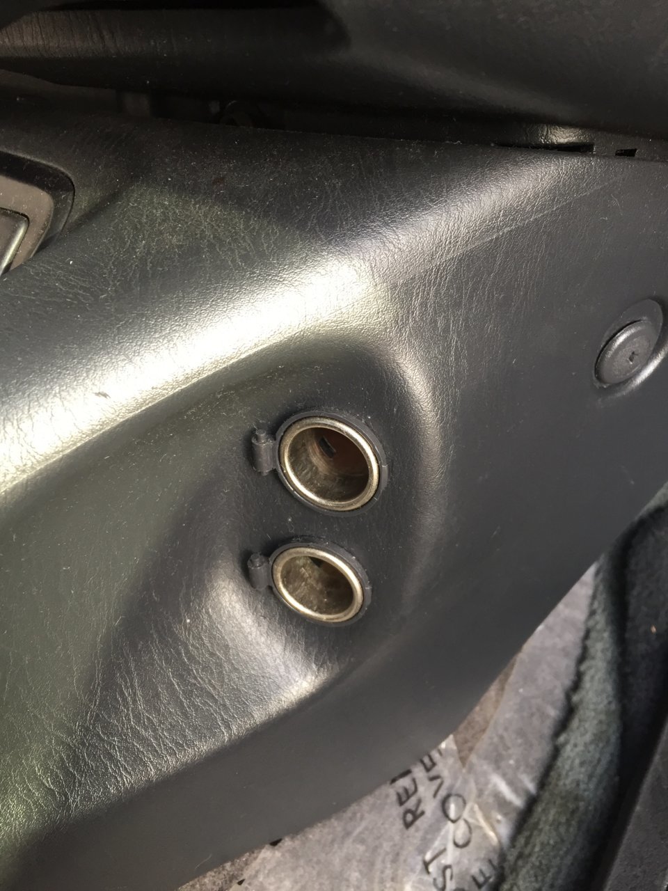

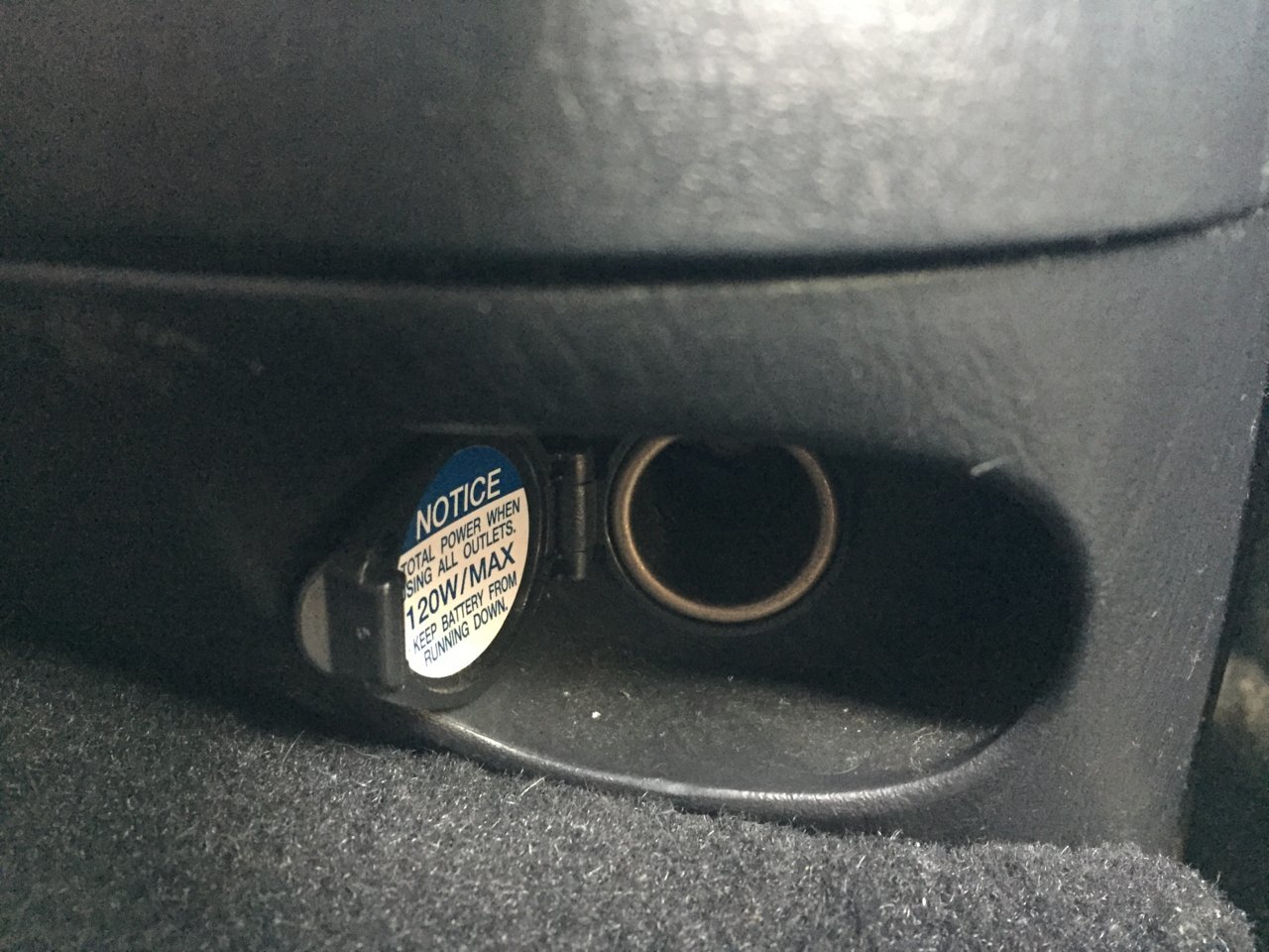

    Thank you @BubbaW,would this be the same fuse for the ones in picture? The ones i took pictures are the ones located on passinger flooring side and the other one is located under back seat cup holder.

    I do understand....
    The two you are showing AND the rear 12vdc plugin are all 3 protected by the 15A Pwr Outlet fuse

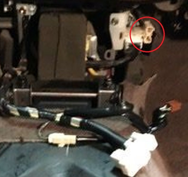

    similar thoughts but I find it hard to believe both fronts do not work if indeed he has tried both. They have separate harness plugs, shown in red circle below. As the above drawing shows, the ACC relay plays a part also. Do they go bad, sure but once certain questions have been answered, it's hard from our couches to know much....KISS. Your comment about IGN ON is very valid and don't want to assume OP is aware.
