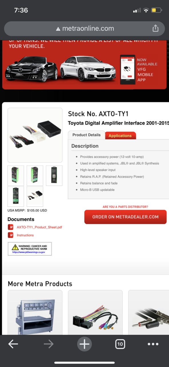

    This is what you use if you want to keep the factory amp working. If not you’ll end up replacing all your speakers because you won’t like the audio. I used to work for an audio shop and they’re easy to use.
    Good luck!
    Ps. Check Amazon out a local audio parts supplier. Usually cheaper

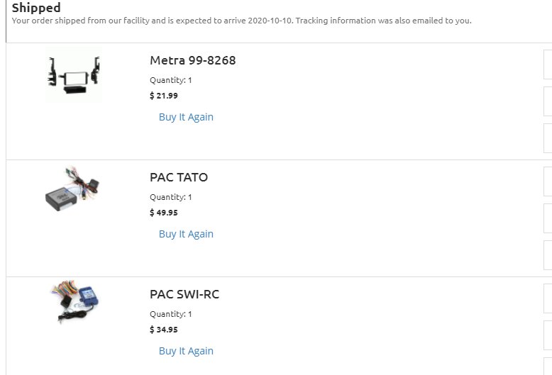

    Thanks for the reply. I ended up calling Sonic Electronix and they advised me to buy the following...
    Hopefully, this will all be fairly simple to install.
    Thanks again for all the help!
