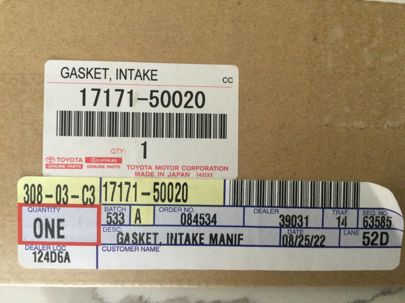

    Intake gasket. @bmf4069 can confirm, he's had this happen a couple times now. ONLY USE either Fel-Pro or OEM on the replacement. You only need the lower gaskets. Don't make bmf4069 hunt down all the threads of his aftermarket shit gaskets he used, then had to replace because they blew out (he has pics, there's a reason he had to do it multiple times)
    They are keyed to go a certain way. I have no doubts someone on here can actually show how they're keyed. Someone recently did this on his earlier-year, maybe I can find it. The later years have a formed rubber gasket.

    This. White tab goes up IIRC
