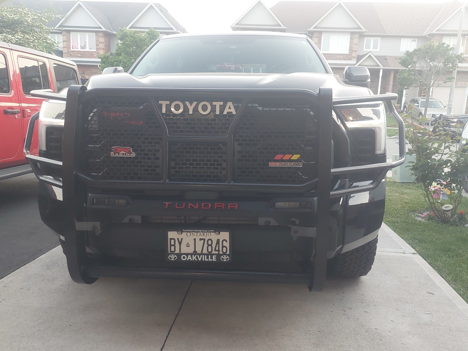

    I purchased an aftermarket grill guard for my 2023 tundra, and it caused my two front bumper parking assist sensors to go off. In order to correct this, I purchased a "sensor relocation kit" to move the sensors to the grill guard. During installation, I noticed the supplied wiring extension in the relocation kit were not the same connection type. I called the MFG, and they confirmed that it doesn't work with the new Tundras.
    Does anyone know how I can get ~2' 6 pin wire extensions for my two front bumper parking sensors?

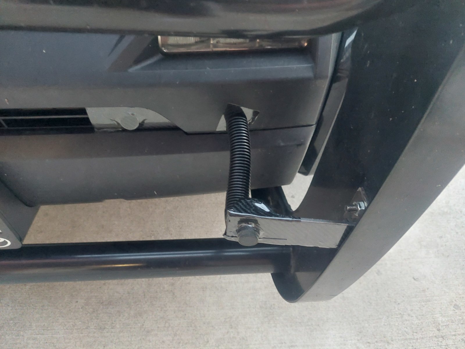

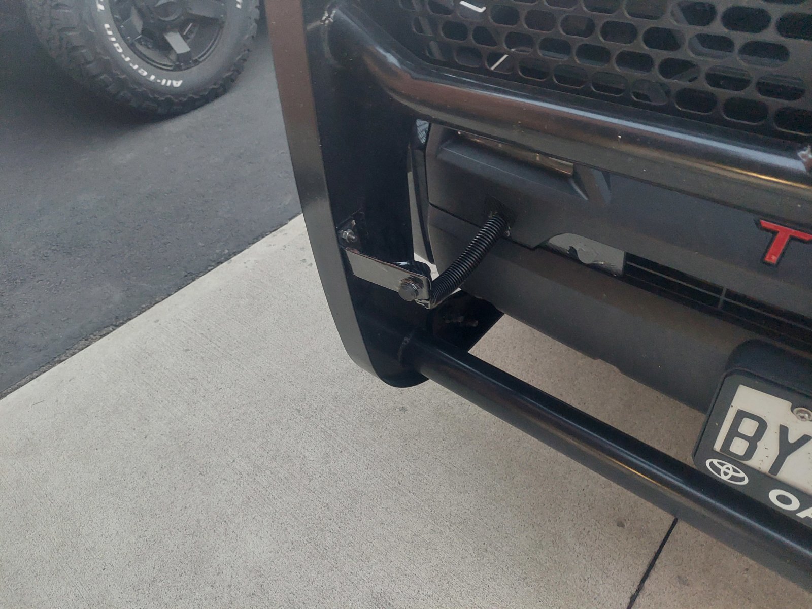

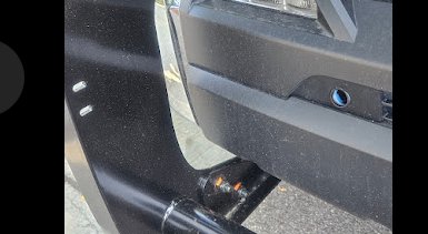

    I have same grill. I made my own brackets. Cut all zip ties done by toyota inside front bumper on harness and you will get enough slack to move sensor without using extensions wires.
