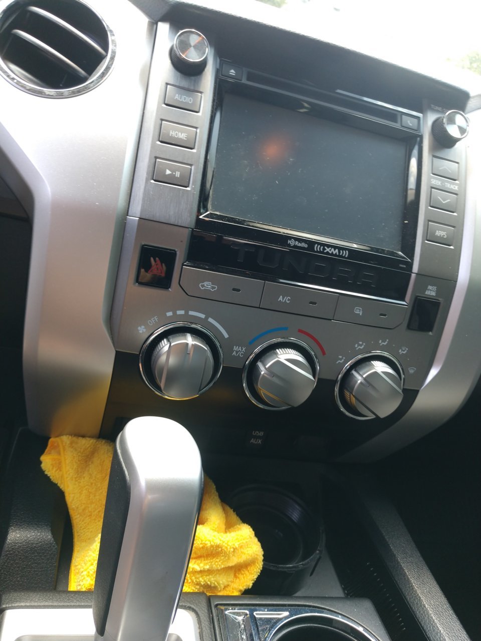

    This is the AC controller I would like to upgrade from. Wondering if any, not too major upgrades are out there

    Digital climate controls require a bit more work in the gen3 trucks. The manual AC air box is single zone, while the digital is dual zone. So you’re looking at air box swap including all the servo motors (requires almost full dash removal), the controller, the AC ECU (called an amplifier), plus wiring and a number of other small parts to fully make it work. Is it possible? Yes. Is it easy and inexpensive? Nope. You might be able to get some function from the Phoenix “tesla” style chinese head units, but not sure - I’ve not researched those very much.

    I see and I suspected something like that.. could it be replaced as a larger module? Inclusive of other parts that might not really be needed but... As a mod it would possibly be simple? Or am I just hoping, wishing, dreaming.... Lol

    You’ll not find one source for it as a single plug and play swap. You’ll have to source the parts and do the work to get everything switched.
    I did it in my Gen 2 (2008), but those have a dual zone airbox so it was a little less involved (by a little - no airbox swap). Even buying used from a wrecking yard, you’ll find the prices can be steep too. Pretty sure all said and done I was ~$1200 into doing it in my Gen 2.
