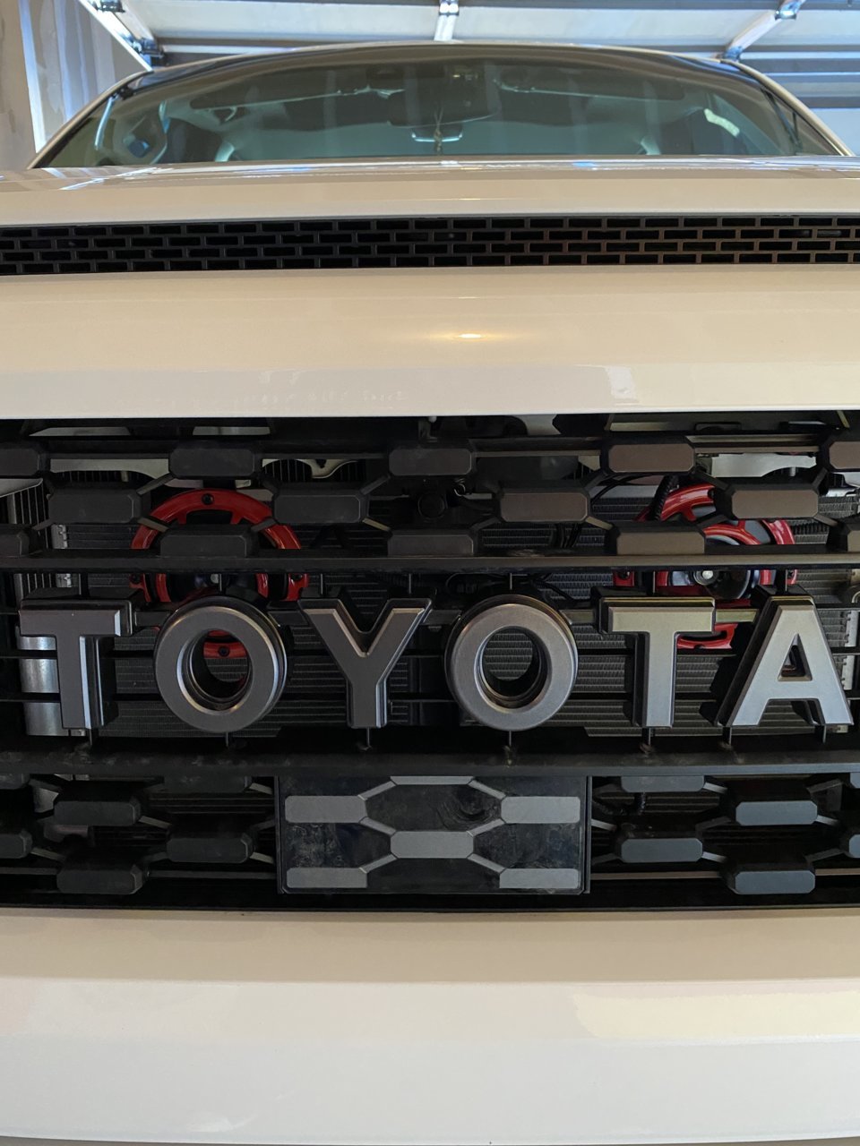

    You dont! I just figured it out. All I needed was the two new horns to be grounded and then just plugged in. I will up load pictures here in a little while.

    Looks mean with the horns and TRD Pro grill
