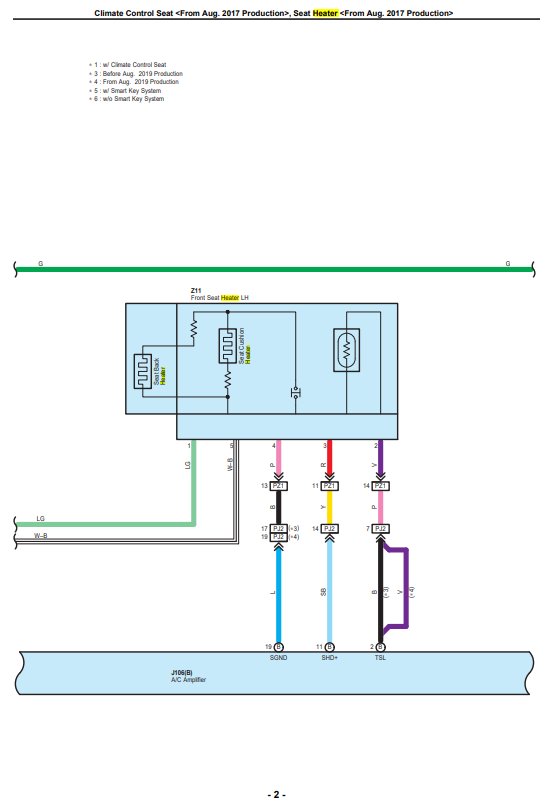

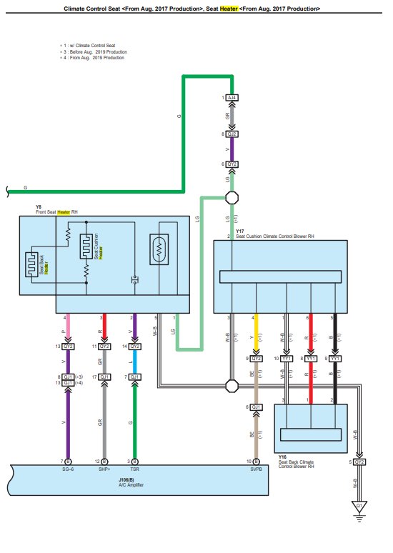

  5. Nov 26, 2023 at 7:00 PM
    1lowlife
    1lowlife Toxic prick and pavement princess
    May 4, 2016
    #3296
    11,795
    DADA
    THE GREAT STATE OF TEXAS
    On my 3rd Tundra 2005 DC 2014 DC 2026 CM Limited
    Looks like the seat heater gets power from the IG No. 5 fuse.
    Where that is, IDK..
    upload_2023-11-26_20-57-33.pngupload_2023-11-26_20-57-54.pngupload_2023-11-26_20-58-24.png

  6. Nov 28, 2023 at 3:50 PM
    DarknessReigns
    DarknessReigns [OP] New Member
    Apr 28, 2019
    #29777
    85
    Thank for your reply. I actually pulled that same diagram from another post I found on here with the electronic PDF's. Problem is, I do not have an IG No.5 fuse. I have all the way up to IG No.4 But that is it.... Still stumped by this.. Not sure if because my truck is a platinum, there are more electronics and the seat heaters run off another fuse somewhere?
