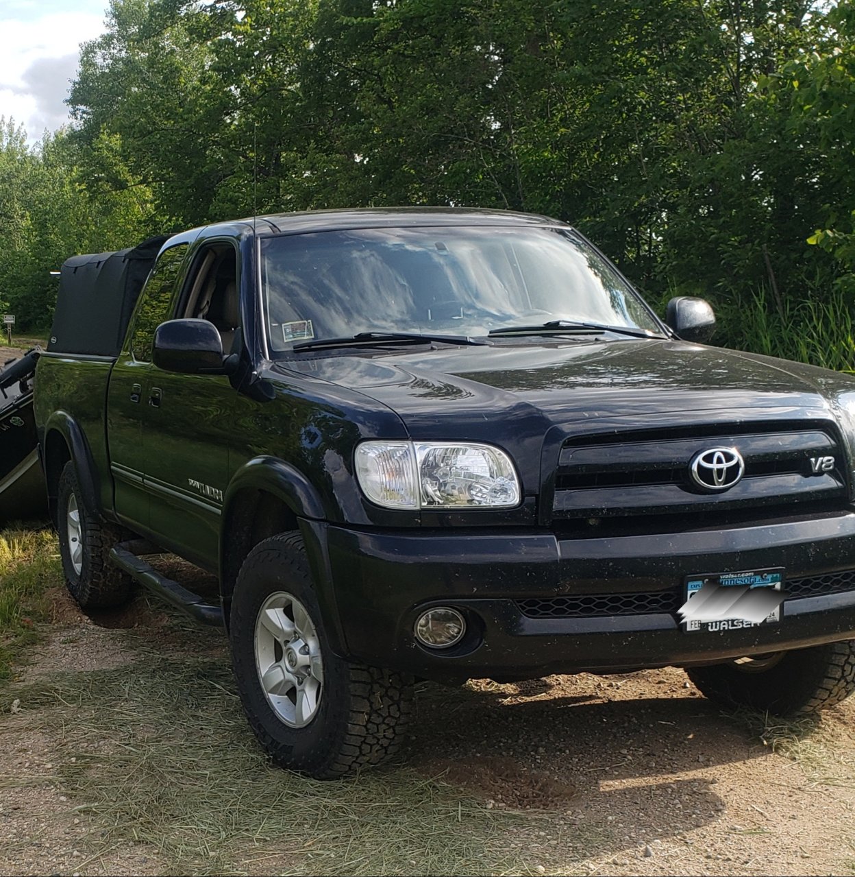

    I have owned four 1st gen Tundras and have been lurking this forum like a swamp thing for years. I currently have a 2005 limited AC 4x4 with just over 225,000 miles that I intend to keep forever. Here she is : (pic taken when I was in a slight pickle with my boat trailer)
    Anyway, the truck is leveled with Bilstein 5100s and Old Man EMU 2884 coils. It also has Freedom Off Road upper control arms, new lower ball joints and new lower control arms and camber bolts. I had an alignment done in June and had new tires installed (Falken Wildpeak A/T3W 265/75R16 116T). Current alignment specs here: Current alignment specs.pdf .

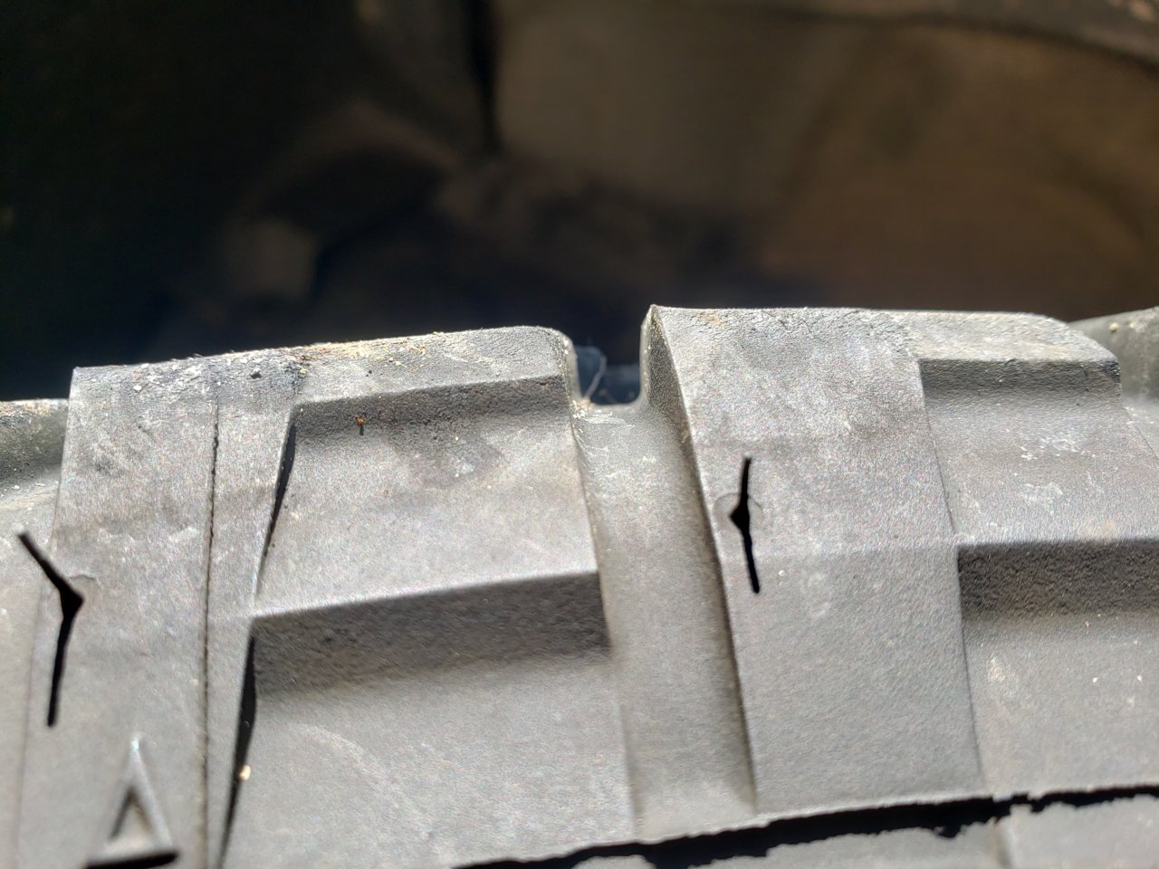

    Here is a picture of the passenger side outer tread. My description of " less worn on forward portion of the lug and more worn on the trailing edge" was wrong. It's actually the reverse of that with more wear on the foreword portion of the lugs and less on the rear. If I run my hand over the tread I can feel those high edges across most of the tread band on the passenger side.
