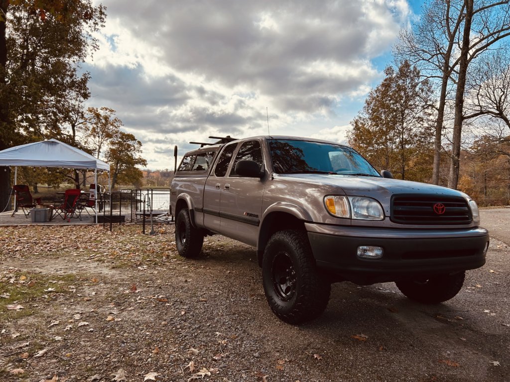

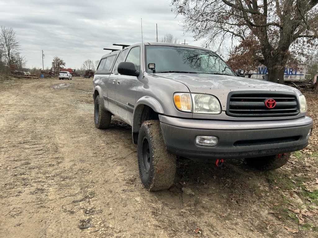

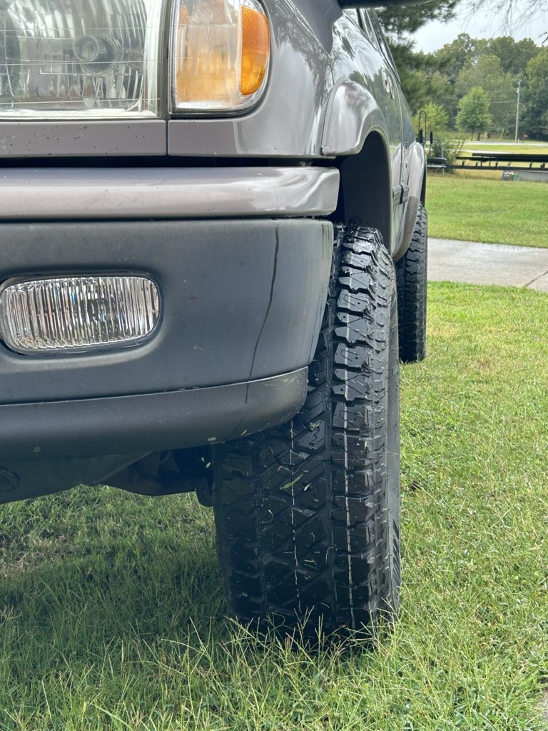

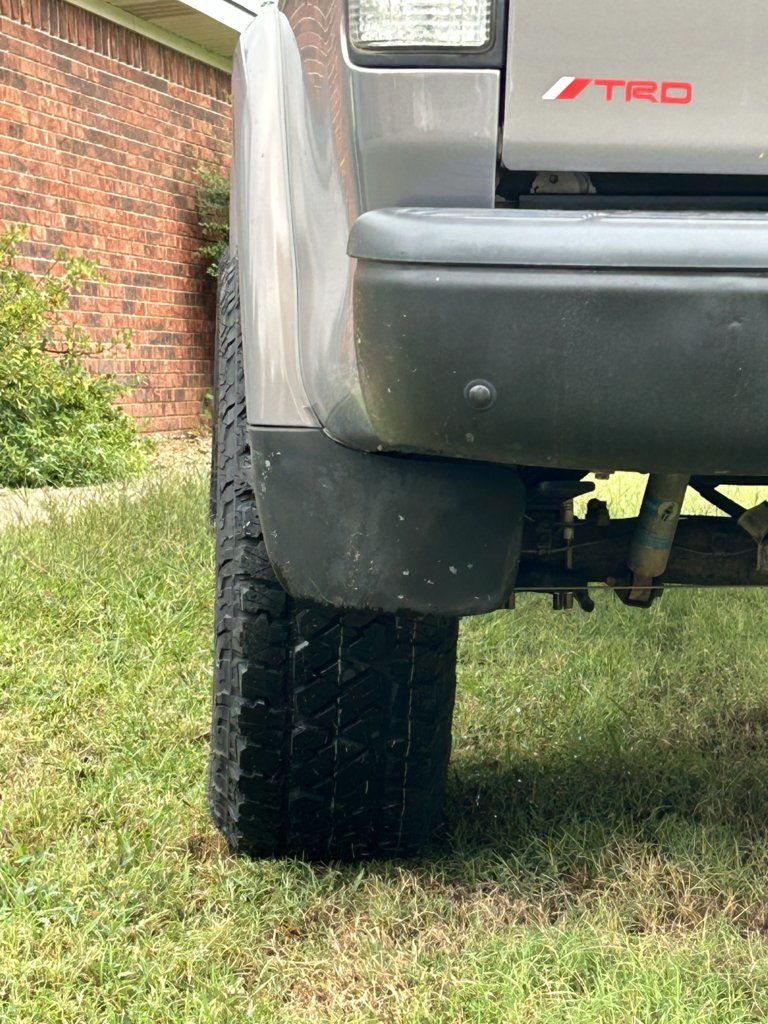

    Zero offset on a 16x8 looks pretty good on FGTs with the TRD / Limited flares. Slightly tucked. Probably has slight poke without the flares.
    With 1.25” spacers (makes the zeros become -31mm or so. The 285s hang just the tread out on the back, slightly more on the front
