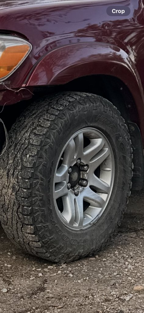

    [​IMG] Morning everyone,
    My truck came with upgraded 17” from the factory. Before ordering new tires, I was curious how many people go from a 17” to a 16” to achieve more tire and side wall?
    My truck has a 6 Bolt pattern and if I could find TRD Offroad wheels from a newer Tacoma that match hub size and bolt pattern, I’d go that route or At least start searching 16” Toyota wheels that bolt right up.
    curious how many people have reduced wheel size, and what wheels did you end up with.
