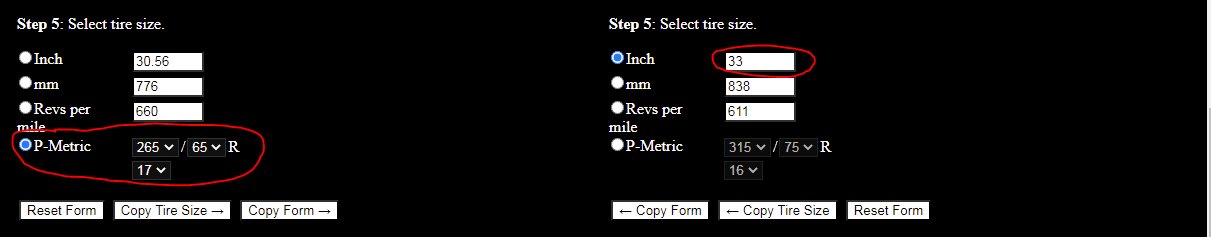

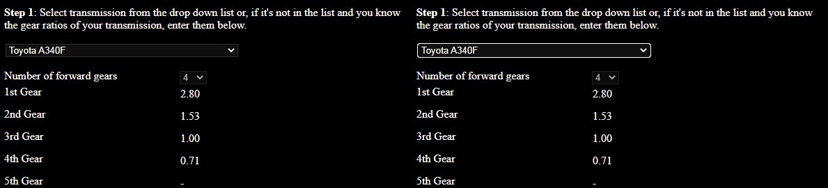

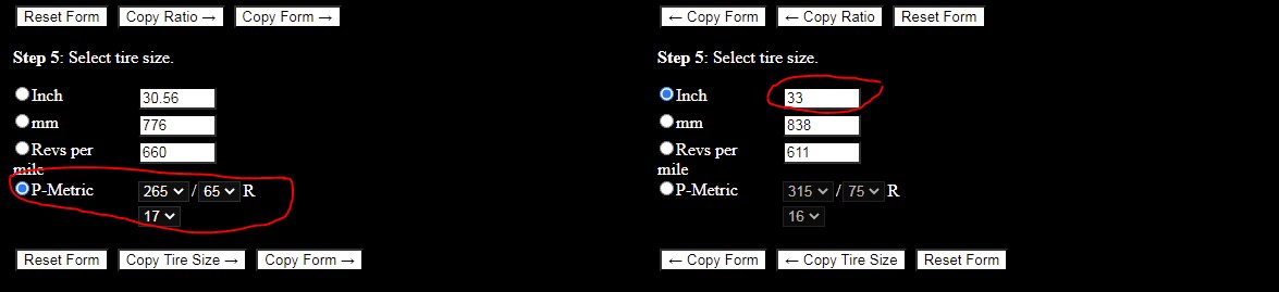

    So @Gdk5514 If your GPS says you're traveling at actual 70MPH, your RPM's should read about 2500RPM. Sounds like your gearing is good. If you're concern, give Nitro Gear a Call, they're very helpful.
