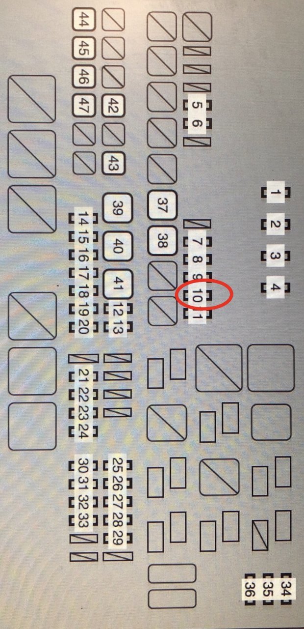

    Description: FUSE 10, STOP, 15A "Stop lights, high mounted stop light, vehicle stability control system, anti−lock brake system, shift lock system, multiport fuel injection system/sequential multiport fuel injection system, towing converter"
    From here, posted and applies to 2016, curiously enough I didn't have this info in my manual: https://www.autogenius.info/toyota-tundra-from-2013-fuse-box-diagram/
