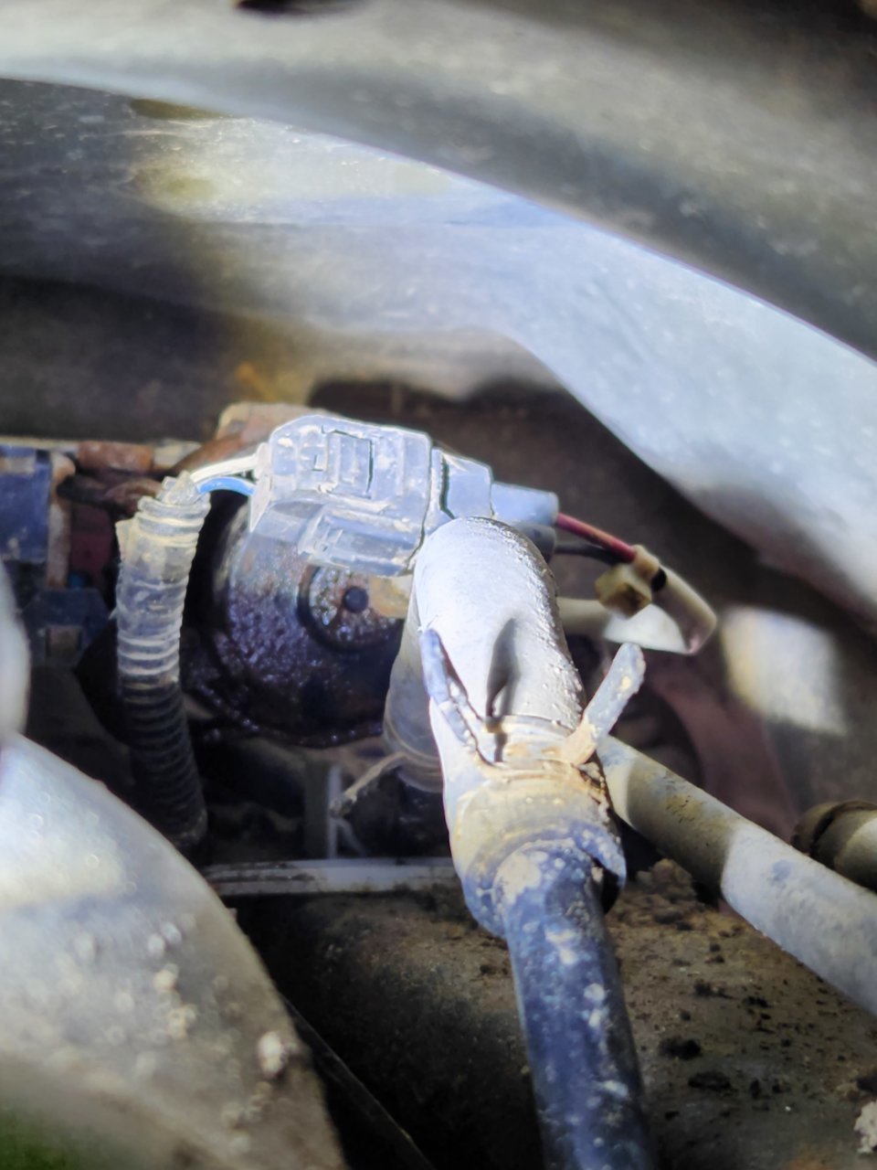

    2013 Tundra w/ 175000 miles. noticed fuel smell and now can see fuel leaking from a cylindrical part above the tank with wires going into it and kind of over the frame. This is near the front of the tank near the front tank strap. Kind of between the frame and the tank. What is this? I'm sure I need to drop the tank to replace it but did a search and can't find what it is.
    Thanks Also right against the emergency brake line.
    Edit: I am posting a picture and you can see it is above the frame. The fuel is coming out of the little hole. You can see it is wet below the hole. It only leaks when there is fuel pressure, also the truck is starting a little bit harder since the leak

    Glad you got it figured out and fixed. Sounds like a real pain in the ass to get to.

    • Compatibility: Fuel tank reservoir selector valve compatible with Toyota Tundra 2008-2020, compatible with Toyota Sequoia 2008-2018
    • Replace Part Number: 77070-34010. Please make sure the part is compatible with your vehicle
    • Precise Fuel Control: Engineered to deliver smooth and efficient fuel transfer from front to rear tank at the flip of a switch, this professional-grade selector valve automatically opens one tank while closing the other—preventing imbalance and ensuring consistent fuel supply to your engine
