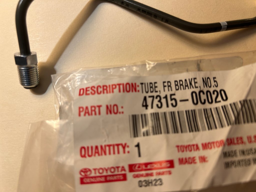

    Toyota sells these lines pre-bent. Here's the part numbers:
    Driver: 47318-0C020
    Passenger: 47315-0C020

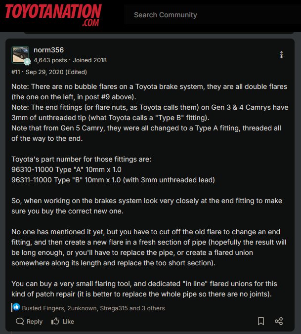

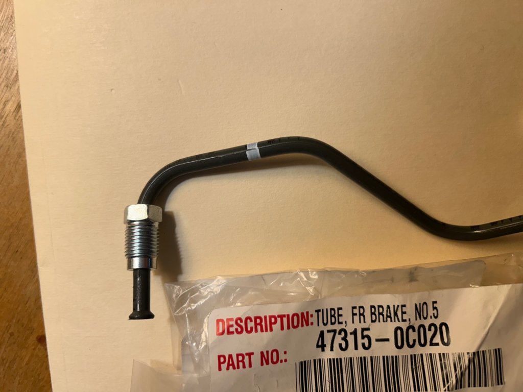

    Resurrecting an ancient thread...apologies in advance.
    When I first saw this thread I ordered the hard lines above knowing that one day they would come in handy. Now that I'm getting ready to install them, I notice that the ends are different (one has threads all the way to the flare, the other does not). Do you know which end fits the caliper and which end fits the soft line? (I assume it matters else why would they be different?

    I've ran into this as well and it does matter, I'm pretty sure the partially threaded one fits into the soft line and the fully threaded one goes into the caliper.
    I came across these part numbers for the fittings themselves, I imagine they're the same as what's installed on your pre-bent line. Use them with bulk 3/16" tube and double flare tool.
    w666[QUOTED] likes this.

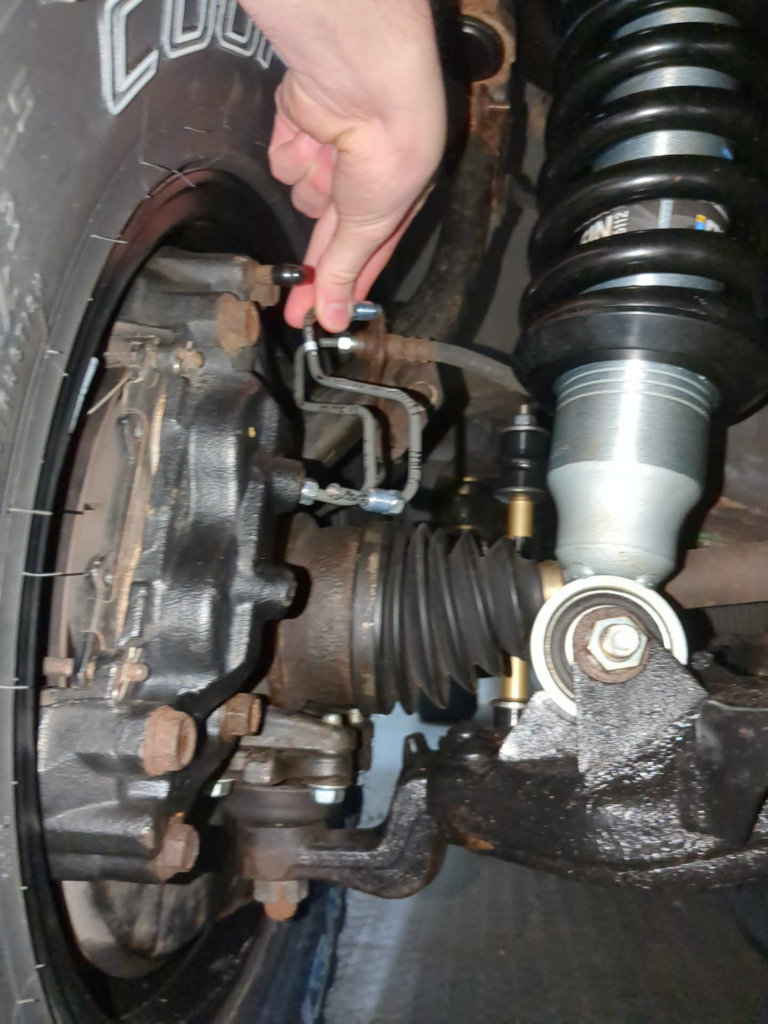

    Well…When I was working on my front brakes, had one of the short steel lines, which was rusty, leak after I installed the new caliper. I wanted to fix it while I had the wheel off and tools out. I had 3/16” nickel copper brake line and fittings left over from a replacement job on my 1997 Ford E350 box truck. So, I flared (double flare) and bent a line up. Guess what, fittings screwed in no problem and no leaks.

    You should be able to match the orientation of the old line. I want to say that it fits well in the correct orientation and the line makes contact or won't easily work in the wrong orientation.
    des2mtn and w666[QUOTED] like this.

    At this point both the hard and soft lines, as well as the caliper (all new) are in my hands. I'm just trying to sort it before I have brake fluid running down my sleeve. I'll attempt to dry fit everything before I open the lines, and report back.
    Update: According to some guy on the Internet (must be true...right?) the partially threaded fitting goes to the soft line
    https://www.youtube.com/watch?v=Eb3mSoDsu7k&ab_channel=Ozzstar'sCars
    shifty` likes this.

    That matches my truck. Doesn't seem like it fits the other way. I think the colored band indicates 'up'

    I can confirm that this end goes into the soft line
