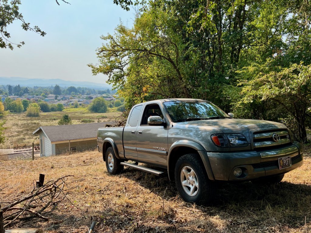

    And here's a photo of the truck, hate the running boards, but have an elderly parent that can't get in without them. They'll come off eventually.
