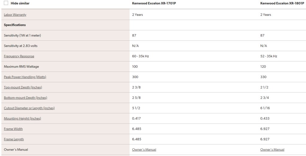

    1701 vs 1801

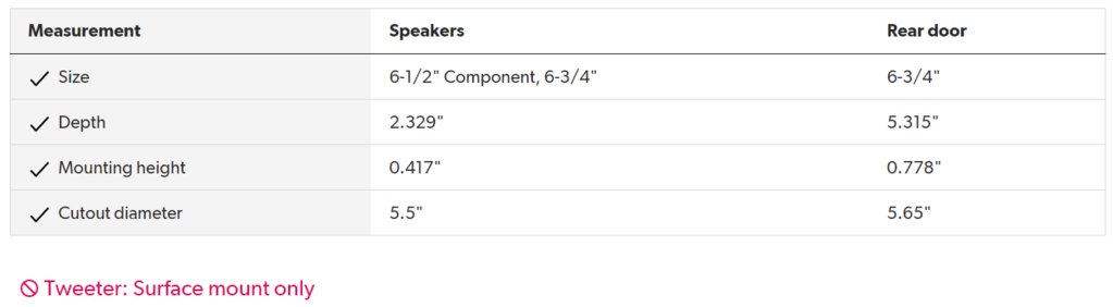

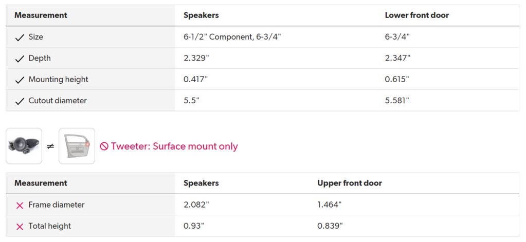

    Front door specs ignore the Speakers (speakers column is specs of the 1701's)
    Rear door specs (speakers column is specs of the 1701's)
    The 1801's have a mounting depth of 2.5" and a front height of .433" for a total height of 2.933".
    The front doors have a depth of 2.347" and a front height of .615" for a total height of 2.962".
    This in theory leaves +0.029" of total depth.
    The front doors have a cutout diameter of 5.581".
    The 1801's have a cutout diameter of 6.0625".
    This in theory leaves -0.4815" of cutout diameter.
    by comparison
    The 1701's have a mounting depth of 2.329" (specs say 2-3/8" which would be 2.375") and a front height of .417" for a total height of 2.746" (or 2.792" if using the 2-3/8 depth spec).
    This in theory leaves +0.216" (or .170" using 2-3/8" depth spec).
    The 1701's have a cutout diameter of 5.5"
    This in theory leaves +0.081" of cutout diameter.
    All that to say, the 1801's would be close on depth when surface mounted. ABS adapter rings could increase the depth, but then it depends how much space there is between the speaker and the factory speaker grille/door card. The 1801's would have too large a cutout diameter to fit, but again, if using adapter rings, the geometery changes and they might clear the holes.
    Where there's a will there's always a way, be it widening the cutouts in your door, using adapter rings etc.
    I think the real question is, is going from a 6-1/2" to a 7" worth the added effort for the slight increase in output/response and if so, I'd be looking into 8" woofers for the front doors because that opens up more possibilities.
