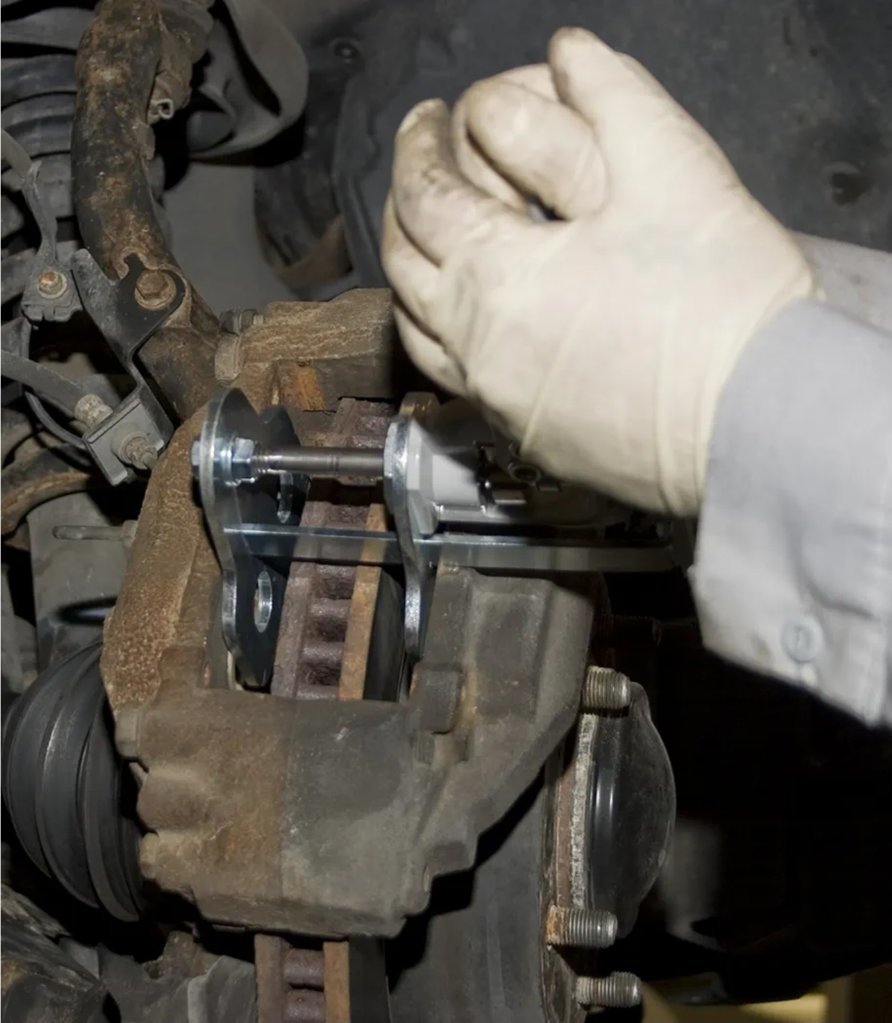

    A medium to large C Clamp will work as well and a large pair of channel locks. I just did mine and they aren't horrible to compress, just remember to pop the top on the reservoir.

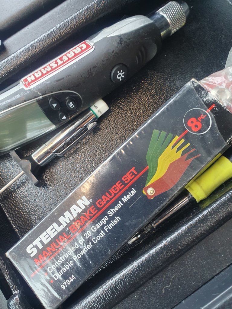

    Buy a brake pad measuring tool like this. I replaced my pads and around 62,000 and they still had some life left in them. Unless maybe you towed like crazy for 32,000 I don't see how they could have worn that fast.
    I bought one and it's great, after using a big c-clamp on the front calipers and one side always popping out after pressing the other side I said I'll never do that again. You can absolutely use a big clamp but it's a pain compared to having the right tool.
