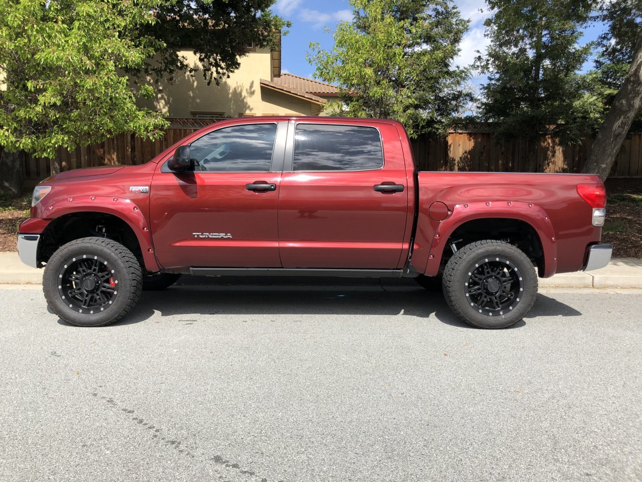

    Do you have any pics of your 1794 with the TRD Fox setup?

    Yes here are some pics after the install.

    Did you need to have your radar recalibrated after the install?

    Actually no. I checked the use of the lane assistance and that worked, the assistance braking seems to work since it did go off once.
    The only I didn’t check was the cruise control but really I’m only sitting a couple inches taller so I really don’t think there will be any issues. Other have said they have had no issues as well.

    Found this on OfferUp.. maybe someone local (SoCal) is looking for a set. Not Mine
