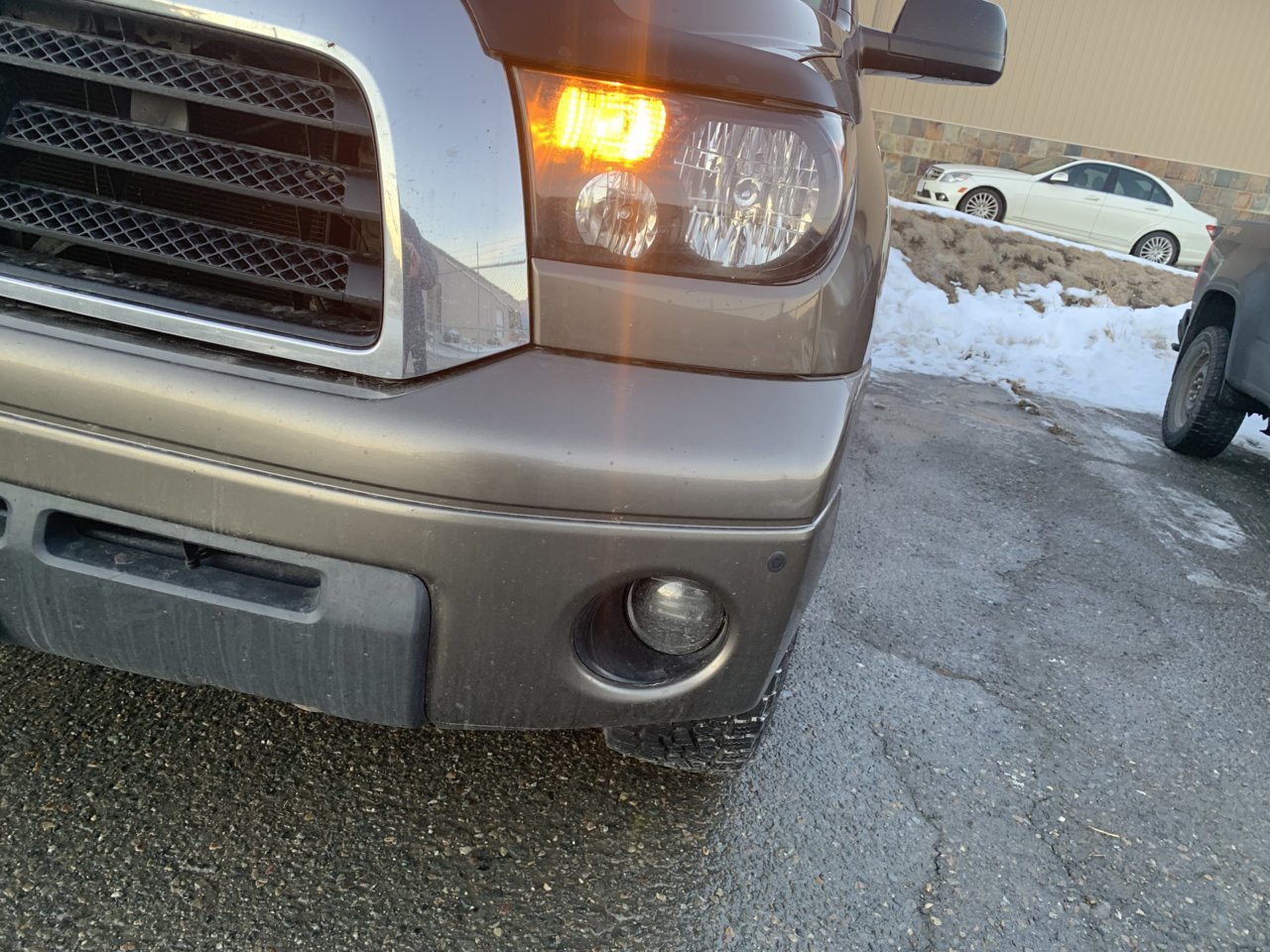

    Just got a new to me 2007 Tundra. It has what looks like aftermarket headlights and fogs or maybe just smoked appearance? Anyways the headlights are very bright and work well but fogs will not turn on. All other lights work and I changed fog fuse with no effect. Anyone familiar with these? Could the headlights be affecting fogs as ecu doesn’t think they are on? They are bright but not sure if led or hid? Hopefully picture attached shows the headlights.

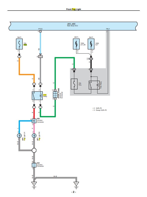

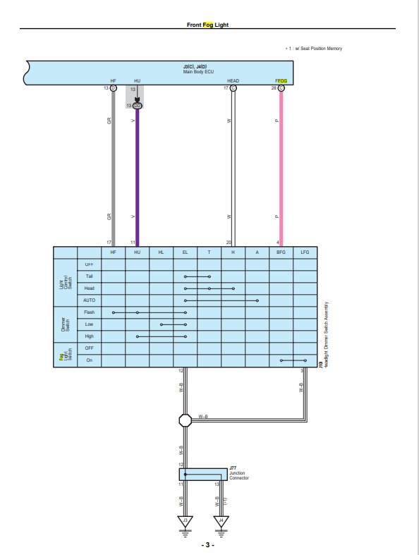

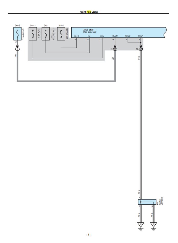

  4. Nov 27, 2022 at 9:13 AM
    1lowlife
    May 4, 2016
    #3296
    11,127
    DADA
    THE GREAT STATE OF TEXAS
    2014 MGM DC SR5
  5. Nov 27, 2022 at 10:13 AM

    Thanks for the wiring info, yes I know the headlights must be on. Do the headlights look led or hid? How do tell? I have always just stuck with stock ones.
