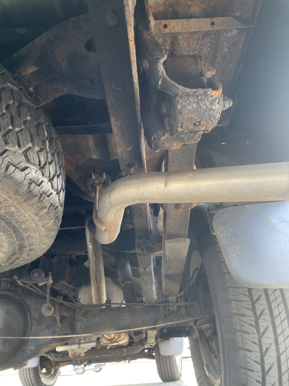

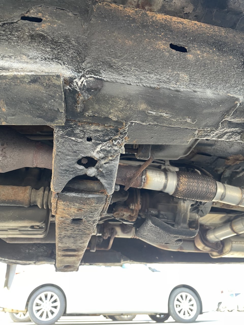

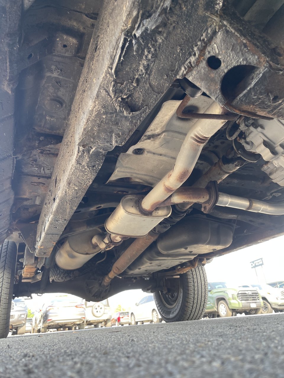

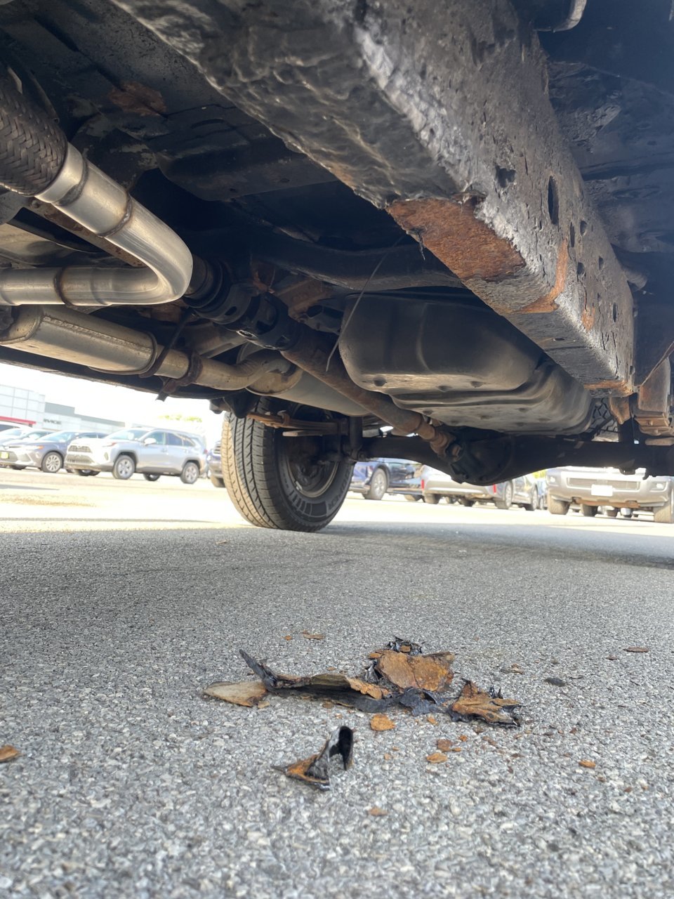

    Heres the pictures I took after picking it up. I cannot tell where they tried to lift from, no marking.
    The stuff coming off in the one photo was a tarish material that I picked at.

    It's rusty. What are your intentions with it? Do you want to pull a skid loader, push a snow plow or....? I wouldn't tow a skid loader, but I would push a snowplow with that. Keeping in mind it is rusty. I think that would make a great everyday-use vehicle for a few years. Maybe an unpopular opinion here. I don't know what the lower ball joints look like, but if they are at least replaceable, then keep it and enjoy it.

    Go over the questionable areas with a ball peen hammer to check how solid the frame metal is there. Also check the laws in your area, you may have some recourse there getting sold a truck that should’ve failed inspection. I can’t tell much from my phone but it looks partially repaired and covered in undercoat.

    Update. Took it to a Safe-T-cap installer. Frame is unrepairable and is in-fact unsafe to drive. New frame would be 8-10k and I'd have to find the frame. Which is twice what I paid for it.
