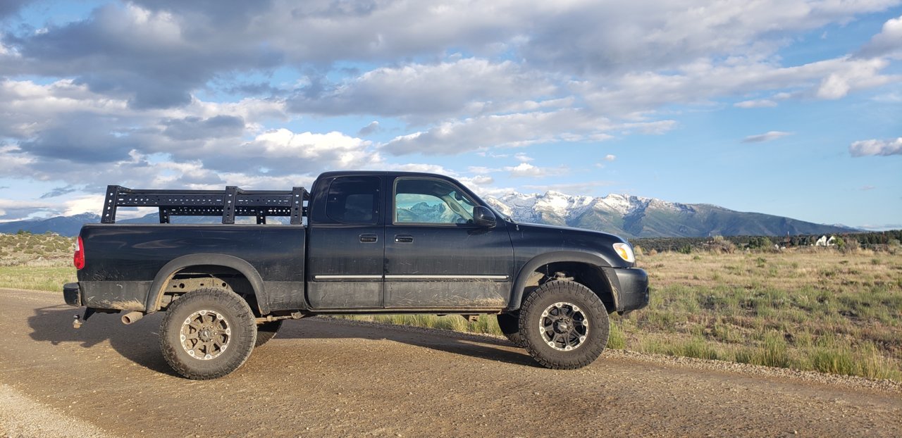

    @KbVoodoo MAX Modular ALUMAX SL 70"
    On my 2006, took some custom holes and I have a little figuring left to do on the back two legs, but I really dig it.20200608_191746.jpg

    Nice, the 70” fits well! I’ve had my KB rack with tent on for over a year now with no issues or complaints. Good choice!

    Yup it's the 14". I can't speak to maxtrax
    or rotopax yet, but with this height I can still reach into my bed from the sides, the rtt won't cause too much drag or be as exposed compared to taller, and I can still crawl around in the bed
