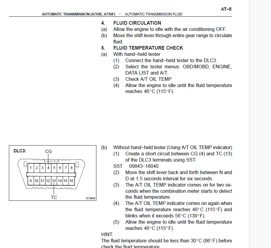

    Well i'm looking to do a fluid change on my 2005 Tundra and both OBDII readers I planned to use don't read trans temp.
    Wondering if the method of jumping the OBD outlet with a piece of wire and then shifting back and forth between N and D works for these trucks?
    I would prefer to use a scanner so looking into Techstream

    Right out of the FSM

    That’s exactly what I needed, thanks!

    Thanks again Fragman, that method worked as it should. Turned out I had some extra in there cuz I put back what I pumped out and was sorta shocked at how much came out of the drain tube
